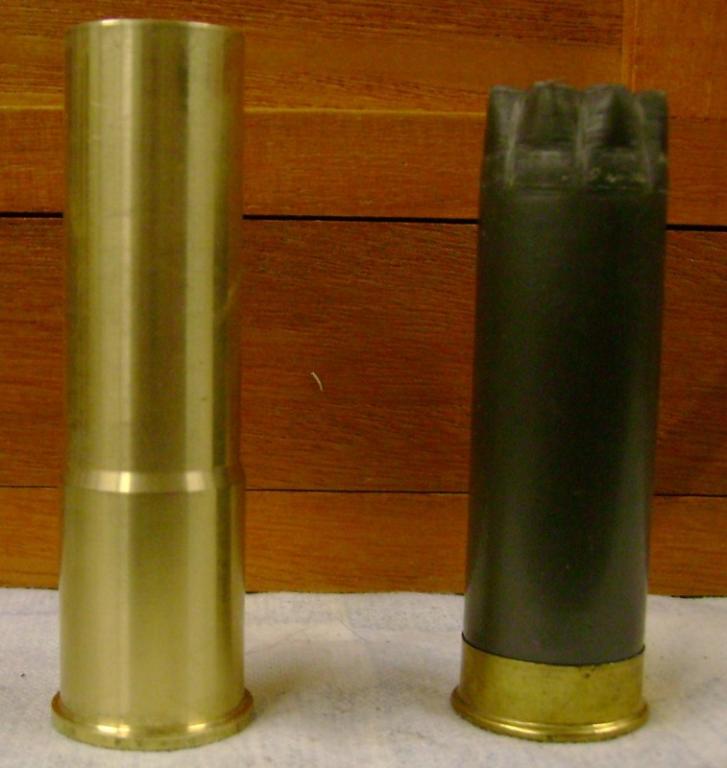

The alternate is to make some forming dies and use 12 gauge brass shot shells.

From the manufacturing standpoint it makes sense to build them that way. The idea of using a bottle neck shotgun shell is appealing to me but reaming to a standard chamber would be much more simple in the long run.

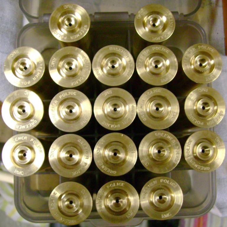

Brass is available from Rocky Mountain Cartridges, about $9/each

and Yes I saw that Rocky Mountain Cartridges was advertising turned brass cases, but at $9/ea I thought I could do something cheaper, just need to get the lathe moved out to the new place and set up.
