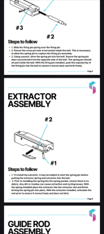

For anyone with doubt, this is Grey Birch's assembly manual for their bolt. It was a copy of the Volquartsen competition bolt. It is not compatible with a standard 10/22 extractor.
