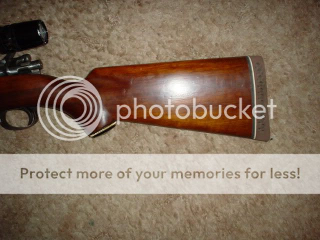

Here's a picture of a recoil pad installation that River Rat did for me on an old FN Sporter. You'll never guess what he used to grind the pad to match the stock profile.
An angle grinder.
He never touched the wood, and got the stock lines near perfect! :cool:
