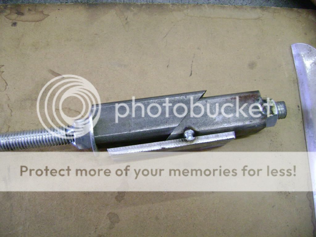

Here's a simple square tube dent remover.....you could make one for round tube as well.
If you can support the tube on the outside with a tube slightly larger that just fits over it you could probably do the work easily with some needle nose vice grips and a small block on the inside to push on the dimple.

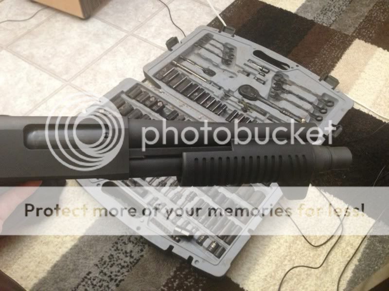

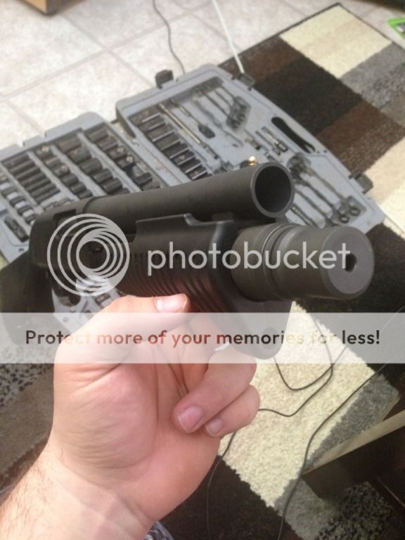

used the socket method, did alittle work with a 1/4" punch on the outside once the socket was in place to smooth everything out. threw the +1 on and she JUST holds 4! the springs works but i may cut an extra spring i had for another 12g i had laying around. heres some pics. what do you think guys, too ugly? i think it sort of adds a rhino like quality.. haha
If it barely holds four now, it probably won't anymore if you put in a longer spring. it looks okay, but to be honest I wouldn't worry over the extra shell
