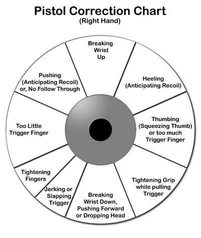

Try a slow fired 5 shot group then rest while you reload your magazine. The correction chart above is very good and accurate but since 8-9 out of 10 are in the bull your last two should be there too.

Then it's a heeling issue. Your anticipating the recoil slightly and using a bit of pressure on your trigger finger and grasping thumb on your thumb rest that will cause your muzzle up/right slightly.

When I've had that and could not find another cause I opted for the "too much trigger finger".... which is one of the options in the slow target shooting chart noted earlier.
Clearly from all the options in that chart and the other posts it's not the only possible cause of the shift to the right. But if you're pretty sure that you're holding the gun nicely neutral in all other respects and not gripping too hard then try putting your trigger finger (assuming right handed shooting) a little less far onto the trigger. Or if you are a leftie then try putting your trigger finger a little further in through the trigger guard.
The goal with the trigger finger placement and how you flex the trigger finger joints being to pull the trigger directly back with no side to side tension in the pressure buildup.
