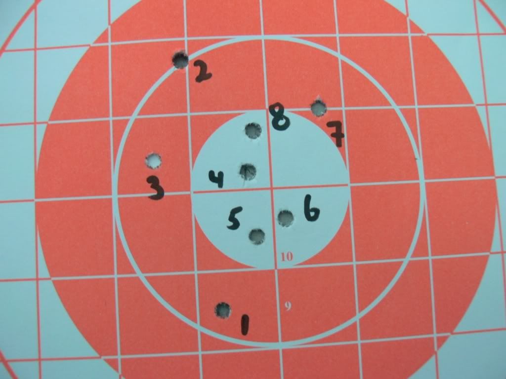

Starting to get the hang of things - it was pretty windy, so I had to make some adjustments. I bet I can tighten things up & start trying longer shoots.
I numbered the shots in order - Rem .223 UMC factory.
Cheers!
D
That's not bad shooting, about 1.5 MOA with factory ammo.The rig looks like it should be able to put them all in the white at 200, how windy was it? Are you using a rear sandbag? Maybe try some different ammo & see how the rifle likes it. Keep us posted!

Its was blowing about 15-18mph -
I'll check out the Win whitebox ammo - I think I saw it at crappy tire (17$/box) - does that sound right? Its about 2x as much as the remington UMC that I use now.
No doubt the rig is capable of much tighter groups - clearly the shooter is the problem, not the gun :)
I'm going shooting again tomorrow & I'll post if I get better results -
In the long run I may start loading my own - but for now, I don't have enough experience under my belt.

x2 on rear sand bag, just use a sock. And proper trigger release/shot follow through is another one I would work on. It's hard to give any more advice without watching someone shoot. good work though:). my 2cents
Hey twoshots -what do you mean by proper trigger release/follow through?
I have the trigger adjusted to +/- 2.0lbs - and it breaks well. Do you mean trying to stay on target after I pull the trigger (the gun is on a bipod, so it bounces up when I shoot & I instantly lose the sight picture.) I do not use a rear sandbag - I fold my left arm under the stock (the butt of the grip is in the crook of my elbow & my left hand is close to my right shoulder)
I don't think I am wincing or preparing for the recoil (its only .223) - but who knows, I could be doing it subconciously.
I will try with a sandbag tomorrow for sure -

Walmart $23 for 40 rounds. haven;t bought any in a while, but I think the price is right...
2lbs, thats a heavy trigger ;)
Thanks for posting the eight shot target as well. Much more realistic than a three shot group. If you really want to see what is going on you have to count all your shots, all the time, not just a few three shot groups that look good. I would like to see us make it a ten shot standard on this forum!
Definately get something to support your rear like a sock or bag. For unsupported shooting I usually take my non-trigger hand and put the sling and sling stud in the webbing between my thumb and index. I then grab my shirt/jacket in my armpit making sure my index finger touches the top of the pit.
In terms of trigger work. Be sure you are pulling straight back with consistent pressure all the way through, including holding the trigger at the back after the shot goes off. This way you know you're not snapping the trigger and pulling yourself off target. Also be sure to get in the habit of firing at either the top or bottom or middle of your last breath to minimize body movement. Whatever works best for you.
Also, don't be afraid or dismiss using different brand of ammo. Weight of bullet etc. I've just started reloading and I am amazed what a difference even the smallest change in bullet weight, or muzzle velocity, or brass selection makes in group size, all other things being equal. Just by changing the amount of powder, and thus the velocity, I was able to go from 1.25" groups down to around .6" groups.

shot release and follow through is the 4th marksmanship principle taught to infantry. Once you have established 1 - 3, ensure that you do not effect the rifles position when you SQUEEZE the trigger and absorb the recoil
a flinch can be detected by an observer loading your rifle with an occasional dummy round and watching for movement. Your shot should surprise you ie. squeeze slowly untill SURPRISE the rifle fires
4 marksmanship principles
1. Position and hold must be firm enough to support the rifle
2. Firer must have natural alignment to the target, without any physical effort
3. Sight alignment, or aiming must be correct
4. Shot release and follow through must not disturb the position
4 points of relationship in sight alignment
1. eye
2. center of rear aperture of optical sight
3. correct point of aiming reticle or aiming post
4. Selected point of aim
Procedure for testing the shooting position
1. initial checking of alignment and noting displacement
2. Correction of lateral errors (move legs left or right)
3. Correction of vertical errors (move body forward or back)
4. eyes closed check
5. re-adjust as necessary
ps. only use the bi-pod on soft surfaces to reduce the bounce, on hard surface use a bag or some other soft object for a rest.
for rear sandbag fill sock with dry sand tie off. Place in off hand below rifle but squeeze to lower relax to raise minute point of aim corrections. this will eliminate transfer errs from off hand into rifle(flinch, heartbeat, etc)

Awesome info guys - thanks, I will definitely be trying these tips. I'll post after my next shoot & see how things improve. I figure if I change one thing at a time systematically, I should be able to really dial in on good technique.
I figured the more shots in the group the more realistic it was (I've had some super tight two or 3 shot groups that I knew were flukey, so it is pointless to assume i'm shooting great because of them)

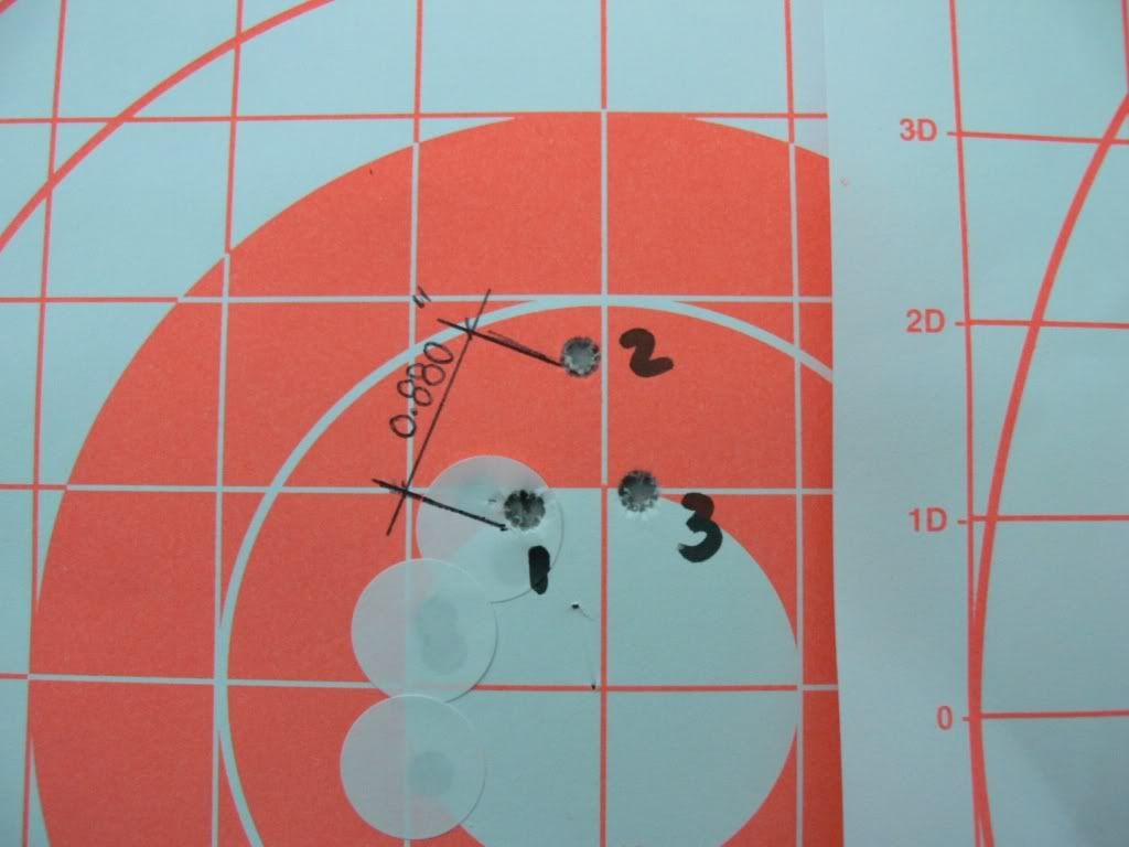

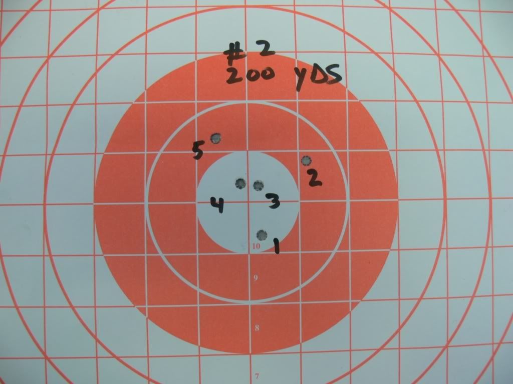

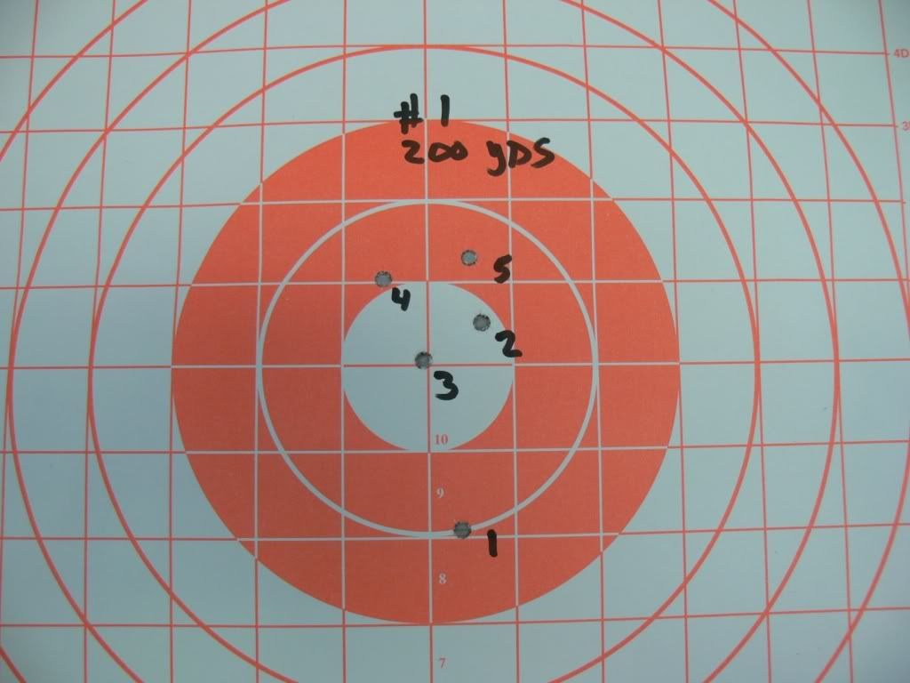

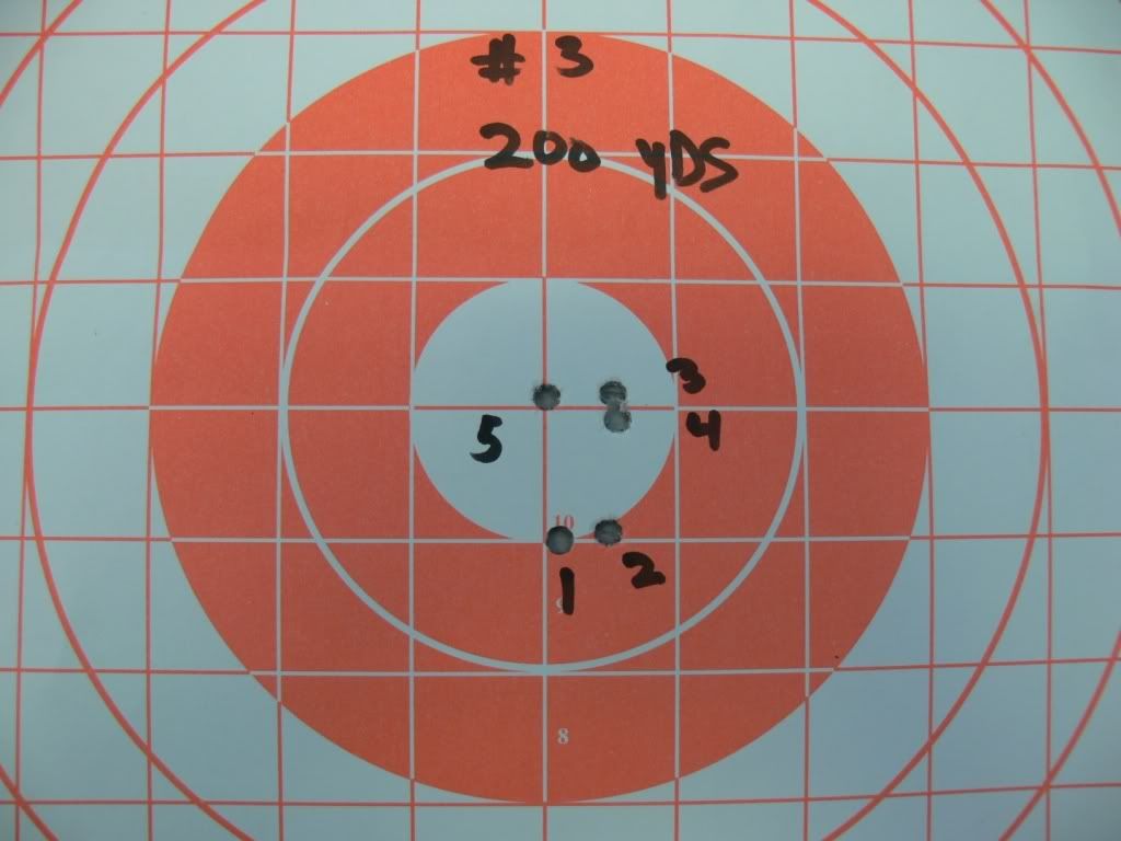

Update - pics of last shoot
I started applying some of the tips & results are getting interesting - great tips!
I used a sandbag under the stock (at the grip) and focused on my breathing & how I was squeezing the trigger. Turns out I am just slightly "anticipating" the shot - rather than being surprised by it. And the trigger pull may still be a bit high (I will try to test & see exactly what its is at)
The pics are all 5-shot groups, and are numbered. All are pretty decent (for me!) but the last group is probably the best I have done so far.
I took my time between shots to keep the barrel cool - and I stopped fiddling with the scope (I have a bad habit of chasing shots around the target)
Cheers guys!
Thanks - would that be about as much as can be expected from factory ammo, or can I get it down even further? Feels like the gun can do better & I'm the weak link right now -
