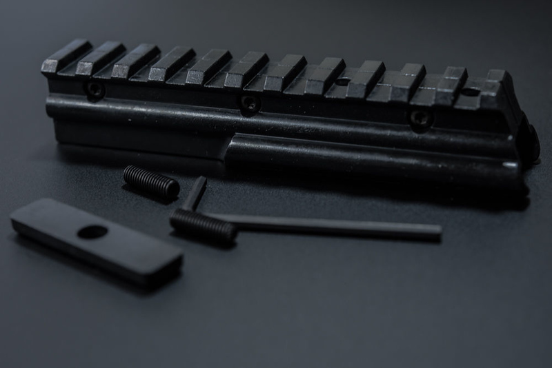

GSG STG44 .22 Caliber Scope Mount

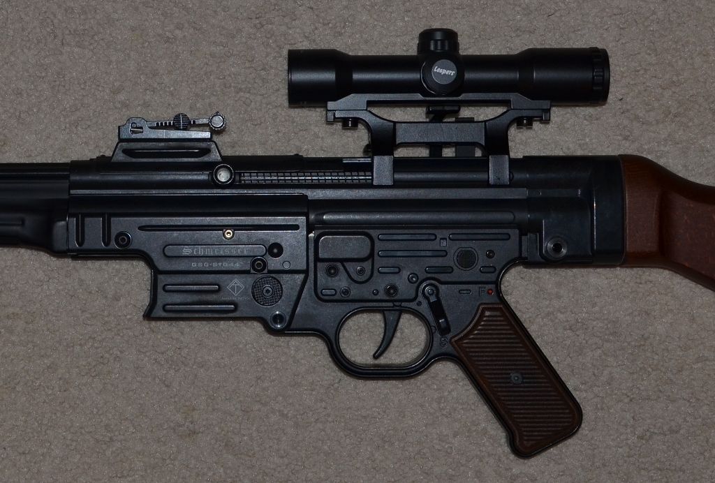

GSG makes a claw mount that's actually for their MP5/22. But it fits the MP44/22 perfectly. Gets around the eye relief issue since it mounts in the same place as per your historic pictures. The metal on the 44 is soft though and the claw mount will mark it if you are not careful.
See if this image paste works.
I used the claw mount and it worked great, save that the rifle had, or had developed, a wobble in the barrel trunion that meant the scope would not hold zero.
After searching a bit, I finally purchased a Gen 2 mount from Colonel Mustard.

Had some issues with trying to get some mounts to work on mine. The cheap Amazon 4 or 5" Picatinny claw version, Colonel Mustard sells the same one, like 18.00 cheap, the claws wouldn't get down far enough over the rails on the side, kept slipping up, only had vertical tightening capacity, which with the jaw profile, vs the rail profile, wouldn't grip properly. Didn't really allow enough for and aft movement either, and the screws and spring setup in that mount are not very strong.
I have the high H&K MP5 style claw mount on it now, took a bit of futzing with the lock travel on it to get it to work, but it does. Also have the GSG version as I was finally able top get one, haven't tried that yet. The H&K mount is a heavy character as well, with the scope, likely pushing into 13 lbs now. I like the gun, it is a shooter, no issues so far. There is another STG thread where I think i put pics up, and maybe a better desc of the mount issues.

The Gen 2 mount came in from Colonel Mustard. Went through some of my rings and didn't really have a set for a 26.5mm scope. (Rifle PU scope) Just 25.4mm and 30mm.
Might have to do some searching.
The rings I used are 30mm x 21mm H. Lots of room if I want to drop in a bit. Cannot see either hard sights looking through the scope. I might get a 10mm H set and see if that will work.
The Gen 2 has 14 ribs at a length of 13.7cm giving you a little wiggle room.

Here's a real STG 44 with scope.
Here's how mine turned out

BTW I also have, NIB and never mounted GSG 44 Scope mount.
PM me if interested. $50 shipped to the majors.
Here is a picture of the GSG scope mount on the 44 (not mine).
