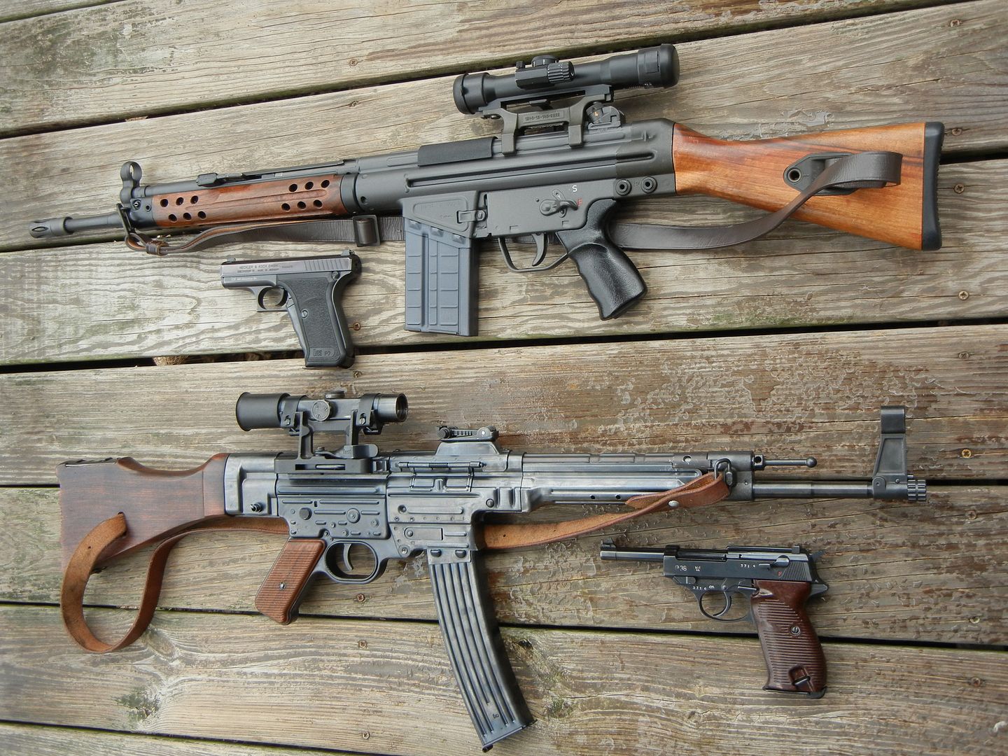

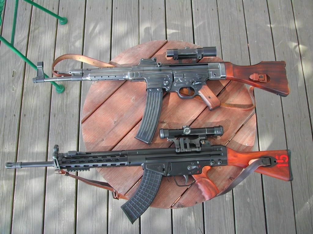

UTG 2nd Gen HK STANAG Steel Claw Mount on the GSG StG44....
Oh, that looks GREAT!!!! I agree with the other mount as being too far forward and not looking quite right. That looks perfect! I want one!!! Have you contacted Irunguns to see if they can get them? Does that actually pivot out of the way to use iron sights too!?

It looks like the mount you have on the pic you posted with the '15' painted on the butt stock, but it is a 1913 rail. The claw mechanism looks the same.
