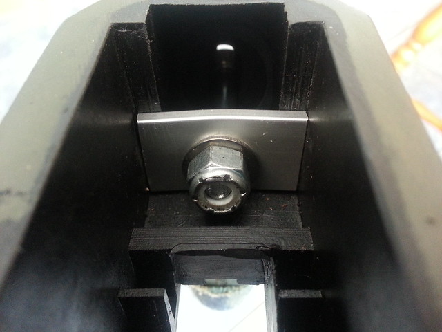

Now slide the aluminum plate towards the back of the stock, hold your pistol grip up to the stock, and bolt it in place.
From the front it should look like this. Notice that my bolt was a bit too short, use a longer one then cut off any extra once your done. Also note that the aluminum plate is slightly bent, I blame that on both over tightening, and using a plate that isn't thick enough. 1/8" thick is the minimum.
Here's what it should look like after installation.

Good work, looks good. Do you think the stock puts your eye a little low with your irons, or does it feel good.
And most importantly, what is that vented handguard!? I've never seen that before.

It's a norinco plastic. The vented handguard is custom made. The cheekrest is at a good height for irons, I made sure that it is where the original stock was for height. And "I only shoot range" ;) I love it!
