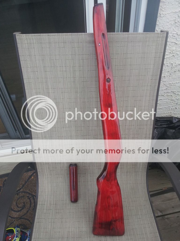

My wood finishing process is a safe process of layering polymerized tung oil ( 20 to 30 coats) with sanding/polishing between each. That seems to be the key for those ultra-smooth, translucent glass finish that some like.
Others like that European oil finish, where there are far fewer coats, and the wood is more open with a thinner, flatter finish. I use 8 to 10 ultra thin coats of pure tung oil to get that, with mild sanding between the first few.
