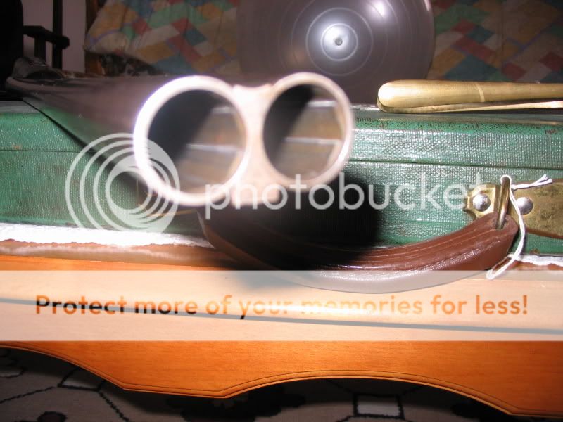

Has anybody played with one of these, just got a mould for this and plan on shooting in the summer.
By the factory records the gun was finsihed in 1901 and shot with black powder with the 750 grain bullet and nitro powder with shot. Bores are good and the last 2 inches of barrel are rifled (new idea rifled choke tubes).
Should be interesting to play with. I just read a article in the double gun jorunal on these but was woundering if anybody else has had any experince.

As luck would have it, at the moment I'm 'babysitting' one very similar to that for one of my shooting buddies while he's on holiday. This one is an H&H under lever, has 'ears' or external hammers and really nice wood. Lots of very fine engraving on the receiver, hammers, under lever, forend release and pistol grip end cap. I don't have an inkling of what it shoots and there's twenty inklings to a clue. On one side of the receiver it says "Charge 8 to 10 drams, Case 3 1/2"". I do know the 'Beast' comes in at 16 lbs on the bathroom scale, the barrels look like a pair of Ford truck axels welded together and each measures about 0.797" at the muzzle. It's huge!!

Nominal 10 bore is .775.
That one sounds like an 8, although I have no nominal bore size reference.

Of what I have read, the 10 and 8 bores are more common then the smaller bore guns. They were like for heavy game because of the weight compared to the double rifles. It will be a 8 bore if the muzzles are 797 and the bores will likely be 835. If the bores are larger then 835, 840 then it will most likely be for brass cases. If you want to PM me the serial number I may be able to date the gun. I did get a letter from H&H on mine gun at no charge and I have a list of serial numbers and dates

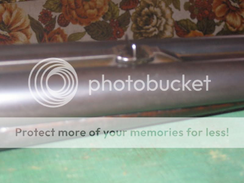

If you could post some photos of the "water table" & "barrel flats" where all of the proof marks etc are. some additional info might be offered.
