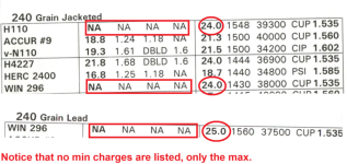

Again, because this powder should probably only be loaded at or very, very, very, near max. Some of the older manuals made it more clear, like this...
The manual you scanned is Lee's, which had NO jacketed bullet loads developed, or tested, by them. It simply regurgitated data published by the powder manufacturers themselves. If you look at a Winchester load manual, you will note that they only give 1 load for that bullet in that cartridge.
Yes, it's Lee's, but I'm not sure why you care that it's regurgitated. A lot of data is "regurgitated". 1) The jacketed load listed is proven, even todbartell in this very thread provided his personal experience. 2) The point of the post being that the OP should only really care about max loads with H110/296 and not worry so much about charge windows.
Some people see the books/data as gospel, others, like myself, see them as guidelines for what's possible.

I pointed it out because none of the loads in that book were tested by Lee. They simply copied what Winchester published. Quite different than actually-tested loads worked up by the publishers of manuals, like Sierra, Hornady, Nosler, Lyman, Barnes, Berger, Swift, Woodleigh.
