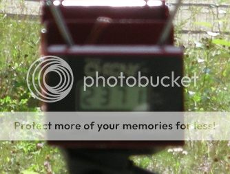

My handloads chronographed at around 2250 fps without any signs of excessive pressure. It's a very strong action so I might be able to safely get more speed. The Hornday LoadNotes for this cartridge lists 2100 fps as maximum in an SKS carbine with a 20" length / 7-1/2" twist barrel.
