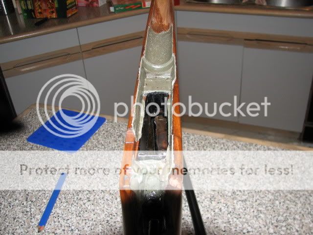

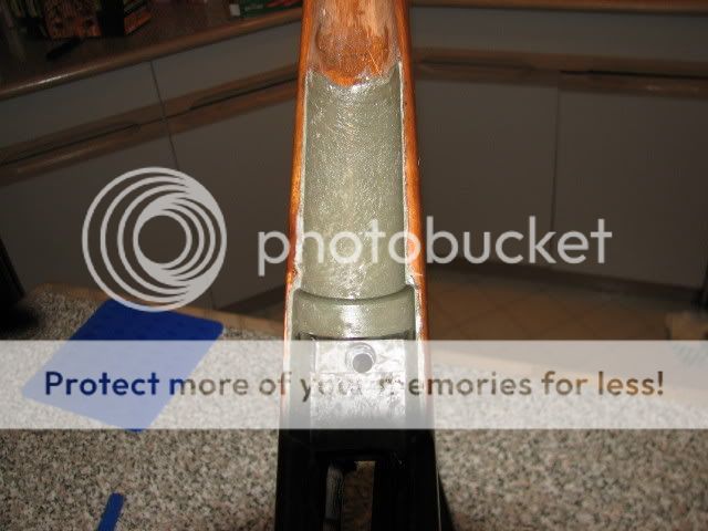

Hansol's Patented Bondo Bedding Procedure
1. Take some sandpaper and scuff up the recoil lug area of your rifle. Bedding agent won't stick to a slick surface, so scuff the hell out of it. Once finished, blow out with an air gun, and give it a quick rub with acetone to eliminate any grease.
2. Mix up the fiberglass bondo. I use about a half-and-half mixture of resin to hardener. If this is your first time, cut back on the hardener about a third. That will give you a bit more time to work with the resin mixture.
3. Put on some rubber gloves, and slap the freshly mixed bondo into the recoil lug area, as well as in the first 4" of barrel channel. There is no easy, clean way to do this, so just scoop it up with your hand and slap it in there.
4. Take off rubber gloves.
5. Now grab your can of WD-40, and spray the hell out of your action and barrel. And I mean spray the CRAP out of it. Get it all nice and covered and gooey.
6. Once the action has copious amounts of WD-40 dripping from it, take it and insert it into the stock. If you have done this correctly, you should see fiberglass ooze out the sides. This is good. Hold the action firmly against the stock.
7. Listen to a song on the radio. Listen to another song. After the second song has finished, carefully remove the action from the stock. You should have a perfect imprint of your action in your stock now.
8. Let the stock sit in a corner overnight. The next day, sand down the excess fiberglass, re-fit your action, and you are good to go.
