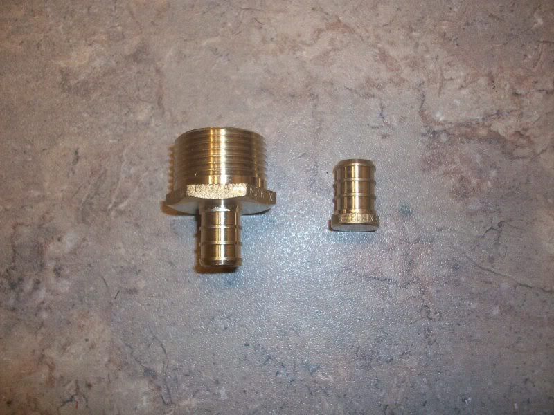

1x 1/2" pex crimp nipple to 3/4" male threaded nipple converter.
1x 1/2 pex crimp plug.

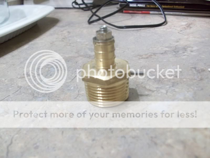

Step 3. Insert and thread the long screw through the plug, and then feed that whole contraption inside the 3/4" adapter, with the long end of the screw feeding up through the 1/2" pex shaft of the adapter.
Step 4. Thread nut and washer onto the end of the long screw. Tighten the whole thing, observing that the center of the plug (now inside the 3/4" adapter) is centered inbetween the walls. Tighten the crap out of the thing.

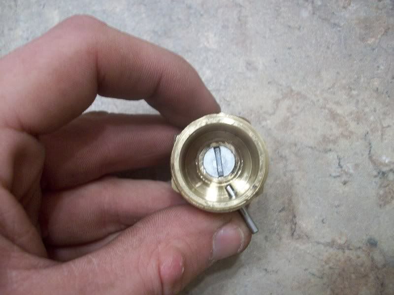

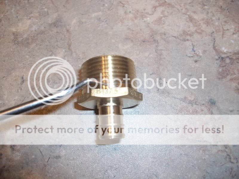

Step 5. Drill a small hole through the side of the 3/4" adapter, right at the edge of one of the flat bits on the outside of the 3/4" adapter. (End of the dental pick showing where to drill)
Step 6. Tap whatever you use for a pin into the hole you just drilled so that it is flush against the plug bit. I used a needle bearing from an old u-joint I had kicking around.

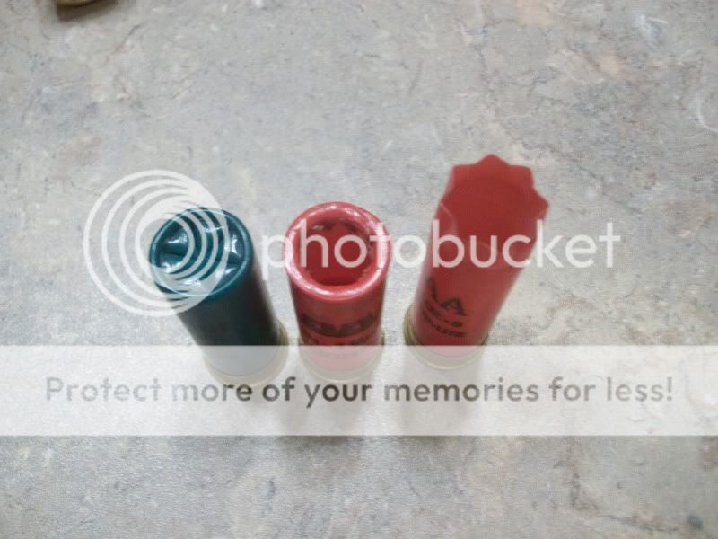

(Left to right: Factory Remington star-crimp, roll crimp made by my crimp tool, uncrimped, once-fired shotgun hull)
