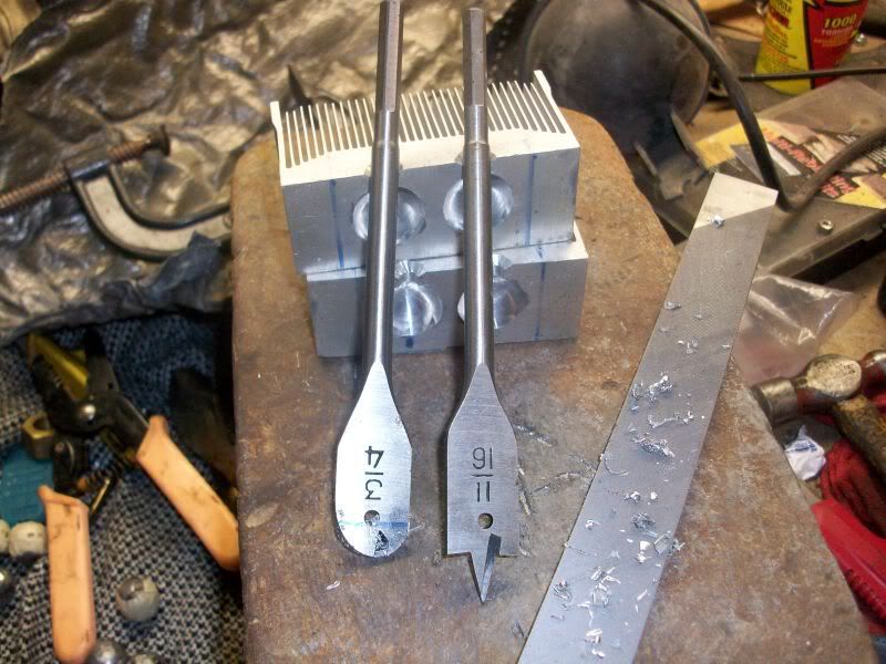

To make a "round" bit, all I did was take a spade bit, cut the nose off, and then file it to make it round. Unfortunately I didn't have any gauges to measure a perfect circle out, so I had to eyeball it. I was out by .005 on each side, so I think I did pretty good for a first effort.

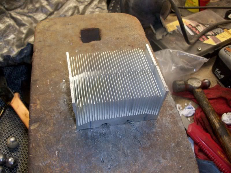

Anyway, start with this:

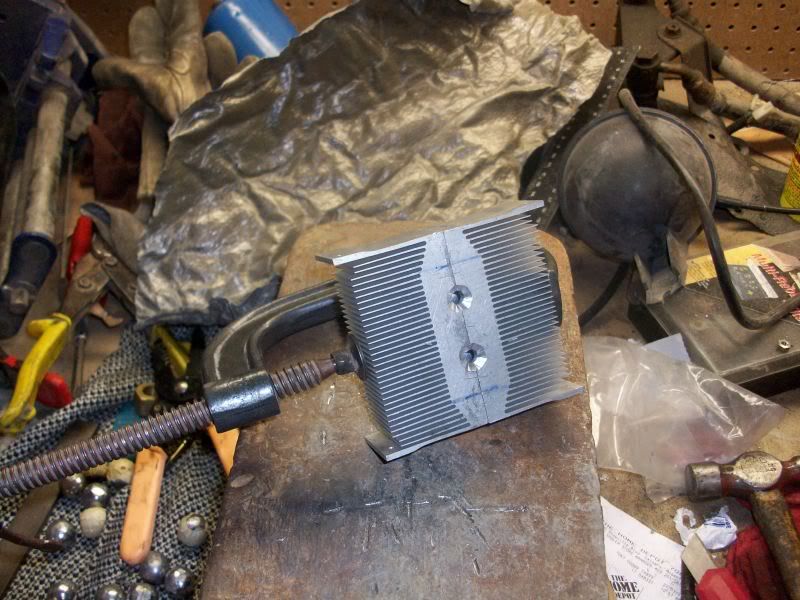

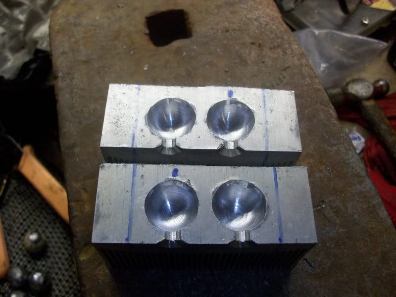

Then take your measurements, and bore out some holes:
Use a c-clamp to hold everything together, and start pouring:

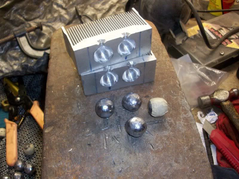

End result:
Here is the "round" bit, and a normal spade bit for comparison:
