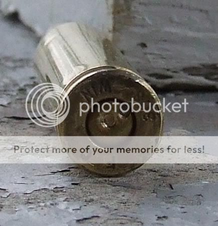

I finally got out to the range on Friday afternoon and shot 20 rounds of factory remington .308 and then my first 8 rounds I reloaded myself.
My first reloaded round went click. I was pissed. :mad: So I waited for a minute, ejected the round, checked the primer and it had a light pin mark. Great, I thought my pin spring is screwed or my pin is gummed up somehow. Then I fired the other 7 reloads and they all worked much better than that crap factory stuff. Federal brass, Winchester primer, 40.0grains of IMR 4895 and a Hornady 165 SPBT. I then tried firing it again but it went click a second time.
The middle primer never fired. Anyone know if there can be a hard primer? I don't think it was my rifle.

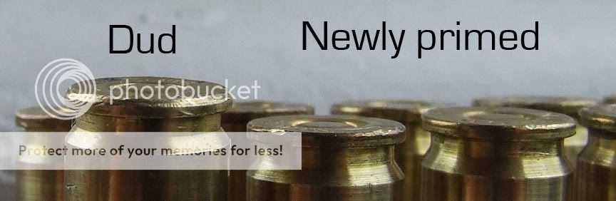

Can you not clearly see that the seating depth of the round in the center is different from all the rest? Looks to me that your primer seating is all over the place. FS
Pretty good chance it is your primer seating depth. Cleaning the primer pocket each time you reload will help, as well as ensuring that the primer is fully seated.
It's hard to tell from the pictures but that difference in seating depth you mention is probably primers backing out when the cases are fired. This supports Stocker's excessive head-space theory.

Ah crap! Yeah, now I see that. God bless the internet and digital photography!

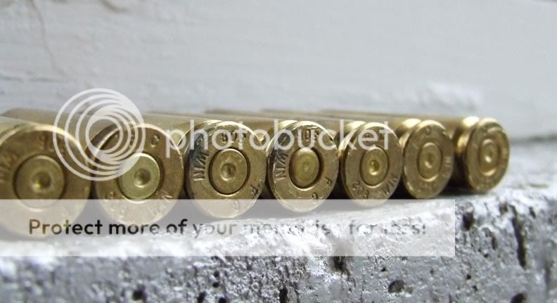

The first picture made my primer depth look awful but I think it is a trick of the light. I tried to use my calipers to check depth and I think the primer is flush if not even just a touch proud! The stuff I primed last night looks more uniform.
This picture shows it clearer I think. I really got to get the hang of my Lee hand primer. :(

Sorry John, before I saw your post, I had pulled the bullet dumped the powder and struck the primer with a punch about 6 times and it didn't go.
I then deprimed, put the primer on my anvil and smacked it with my 4 pound hammer. It went.
I would be willing to bet that the primers are sitting proud on the fired rounds due to the fact that you are using fairly light loads. IMR's website lists IMR 4895 at a minimum charge of 41.0 grains for a 165 grain bullet. With the added headspace the round gets pushed forward on the fireing pin strike and when the powder goes off the primers get pushed back. If it were a heavier charge you wouldn't see that. As for that perticular primer, I'd say a hard cup or double cup like another poster said.
