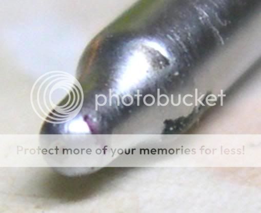

Below the thinner CCI 400 primers caused high pressure gas leakage and the tip of the firing pin was eroded.
And as I stated before you are not the first person to have problems with CCI 400 primers in the AR15 rifle.
