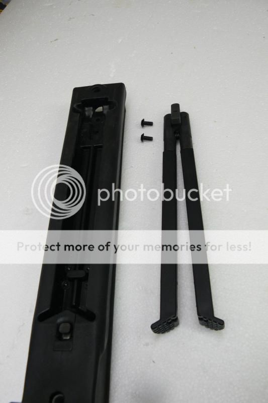

Undo the two machine screws that hold the integral bipod to stock and put in a safe place.

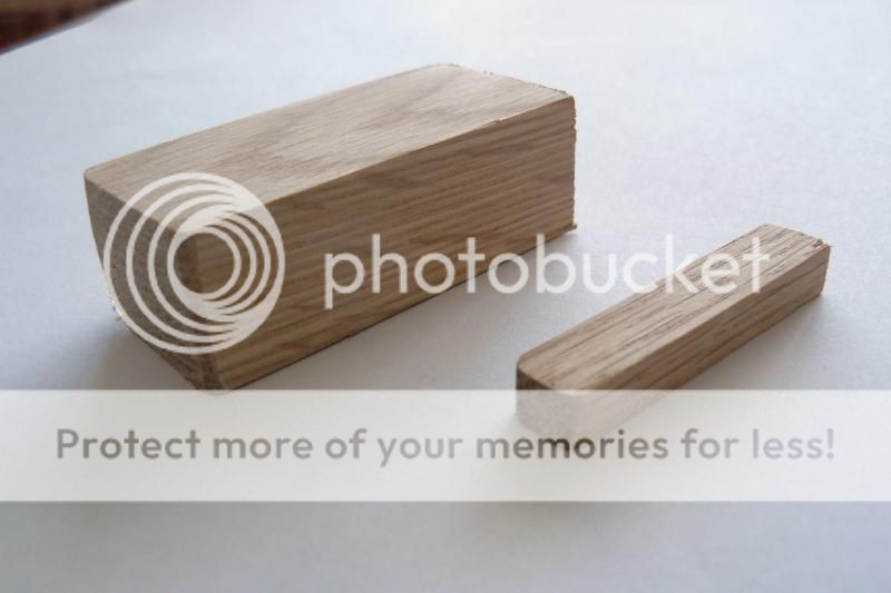

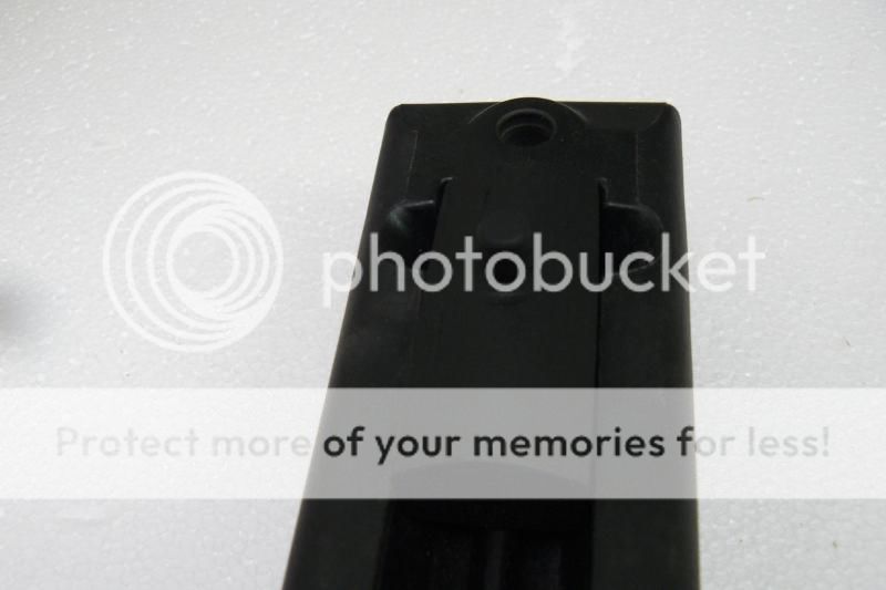

Cut two pieces out of hardwood, I used oak left over from a flooring job. The small piece is 0.375"X0.275"X1.850" to fits the narrow groove of the stock. The larger piece is 1.050"X0.750"X2.200" and fits in the wider groove.

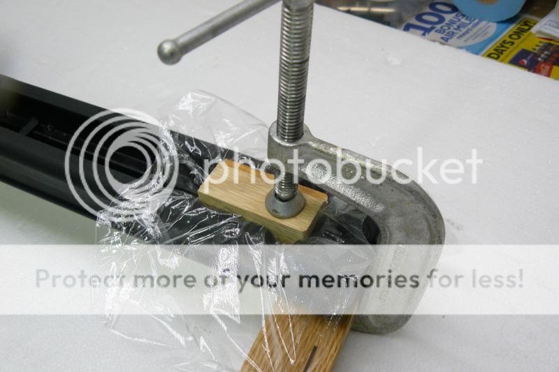

I glued the two pieces together by putting both pieces into the stock. Apply glue to the small piece first before putting the larger piece on top. Note that I put Saran wrap into stock first to prevent any glue escaping from the joint sticking to the stock. Clamp togeher for a couple of hours to let the glue set.

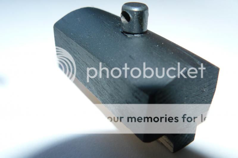

Your adapter should look somehing like this.
Using a flat black spray paint, I painted the adapter black.
Attach the adapter to the stock using the #8 woodscrews. You're basically done now, all you need to do is attach the Harris bipod.

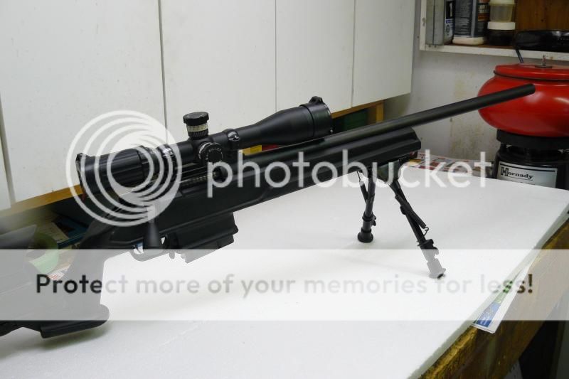

The end result is like this. The whole thing cost me nothing. I had the pieces of hardwood laying around as well as the swivel stud and screws. It feels really solid. I will test it this summer on the range and see how it holds up. All I've got into this is a few hours of labour.
