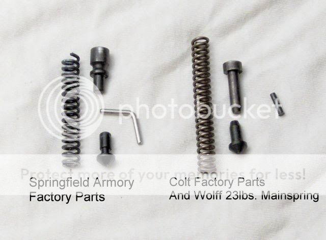

He has a Springfield MSH....they are a little different, there is no retaining pin, you have to #### the hammer, stick an Allen key or something similar in size to retain the plunger cup, then disassemble.
