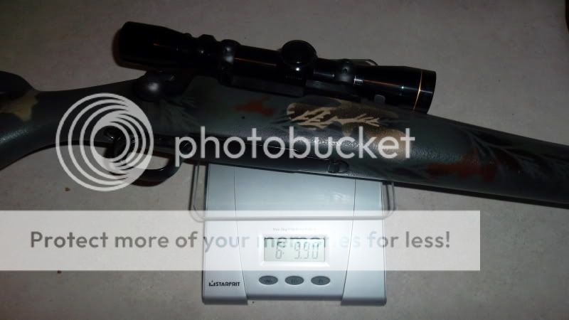

I am fairly new to the 350RM, only been running it for a year or so but really like it. I am a super fan of lightweight, compact, short action rifles. When I wanted to step up from the 308Win I debated for quite a while about what I would go with and finally settled on the 350RM. I mentioned these thoughts to a buddy of mine and he offered me a super package that was exactly what I wanted. He had this rifle for about 10 years or more and hadn't even fired it and knew it would have a good home with me :)
It's a Remington model 7 KS, rebarreled with a 19 inch Hart 1/14 stainless barrel. I got it from him wearing the Leupold compact 2-7 and the Gentry brake. I've since removed the brake and replaced with a thread protector. I must say, she's a little sporty off the bench at 6 pounds, 9.9 oz....
I got the rifle as seen, with dies and 200 brand new brass from my bud. I settled on running the 225 Partitions on top of 61 grains of Reloader15. That load was max for me, running over the chrono at ~2704fps.
62 grains turned out to be a little too much with slightly sticky extraction, ran over the chrono at 2772fps :)
I drew first blood with her last fall on a nice 10 point white tail weighing 174 lbs field dressed :)
I was very impressed with the performance of that combo at 120 yards :)
I love this rifle, it's a pleasure to carry all day, accurate, and lots of punch :)
