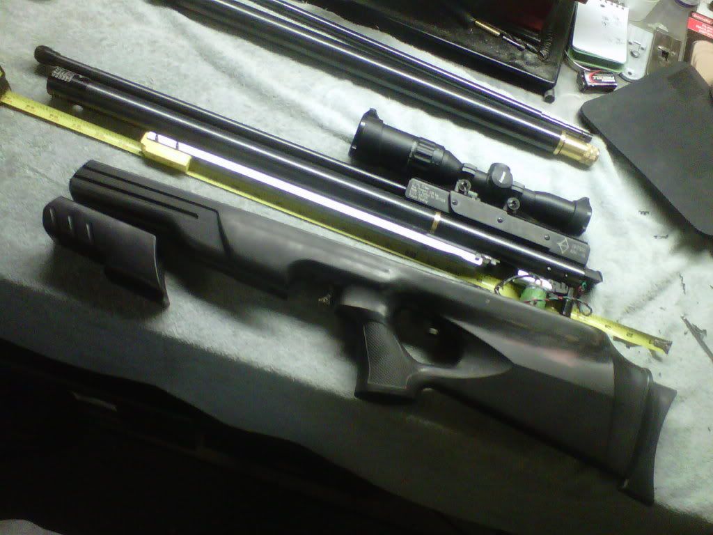

A little closer look at the mechanism. It has a 10 shot rotating cylinder, like a revolver. You can remove the cylinder and carry spares, or reload it while it is on the rifle. You pull back the cocking lever to rotate the cylinder, push a pellet into the chamber, and #### the hammer. Has an adjustable trigger, which is set to a decent weight and brake from the factory. Dovetail mounts for 3/8 and Weaver rings. You fill the air tank to 200 bar (3000 psi) with a tank or pump. After 100 shots it went down from 200 bar to around 175. No change in point of impact.

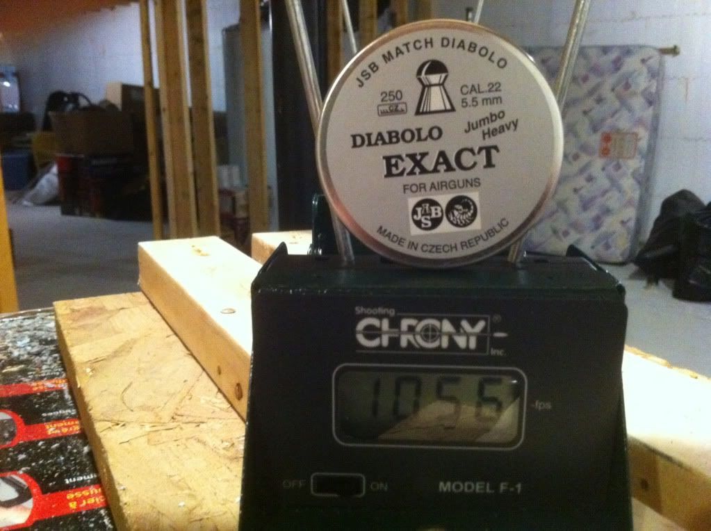

The stock feels great. The pistol grip makes for a nice trigger pull and the flat forend is great for resting on your palm or a bench. The air flow is regulated by a valve with a pin like valve stem. It is currently a large diameter to restrict air flow. You can cut the pin diameter down to increase velocity up to 970 fps with 22 pellets.
