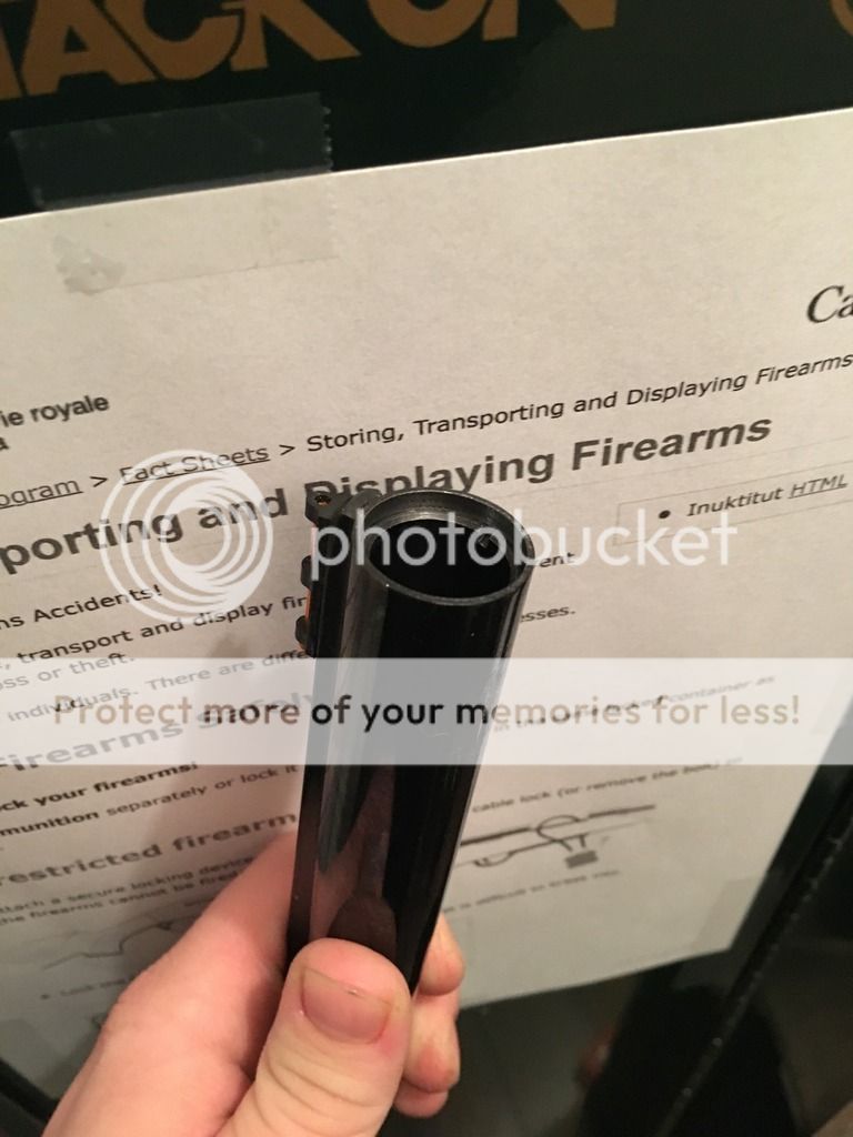

Hello I was wondering if you were able to get hatsan chokes at all ? I'm looking for the set that comes with the hatsan escort missone, Purchased one used and it only came with one choke. Thanks for your time!
EDIT:

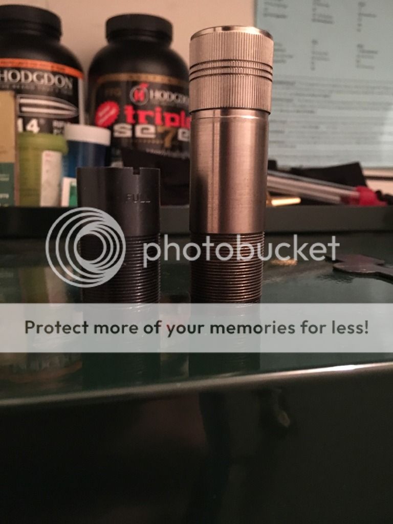

Here are some pics of the choke. On the left is my mossberg accuchoke on the right is the hatsan escort missone . The other pic is the accuchoke in the hatsan, the threads seem a little loose at first but i didnt want to tighten in if not correct and aswell my choke wrench could not get down any more and didnt want to risk having it suck in there. Thanks !
Can post a photo of the choke you have?
Most all Turkish shotguns take Acu/Invector chokes and are easily accessible.

I don't know for sure about Hatsan, but I've seen about 50/50 on Turkish shotguns being either Invector style as EL3 said, or some having a beretta/binelli mobilchoke.
Between the two they're easy to tell apart, invector is shorter (maybe an inch and a quarter, not long) with the threads towards the butt end of the gun, mobilchokes are about twice as long and have the threads at the muzzle end.
Photo's added!
Thanks for info on the Accuchoke if i cannot find hatsan may try and get an extended one.
Yeah, I have heard before that mossberg accuchoke is the same threads as the invector, but i think invector is slightly longer, which makes sense showing the gap to the end of the barrel with the mossberg choke in it.
Does the accuchoke thread far enough in that there's no exposed threads and gap inside the barrel?
not sure if it goes all the way as i didnt want to tighten but will have big gap at opening forsure bigger than in the picture and the invector did look very similar to me, may have to try that one out if i can get one decent price
I have two friends that have ordered a pater master chokes for there hasten they both ordered the beratta Mobil choke and had to return it as it didn't fit. they then ordered a remetion choke and it fit perfectly I felt kind of bad about the whole thing because I showed them a chart that said it would fit that I found online
I Bought an Invector, it does not fit, my accuchoke fits but too small, perhaps i need an extened accuchoke or remmington
Possibly a winchoke maybe? i think they're the same threads, not sure if they're longer or shorter than invector
