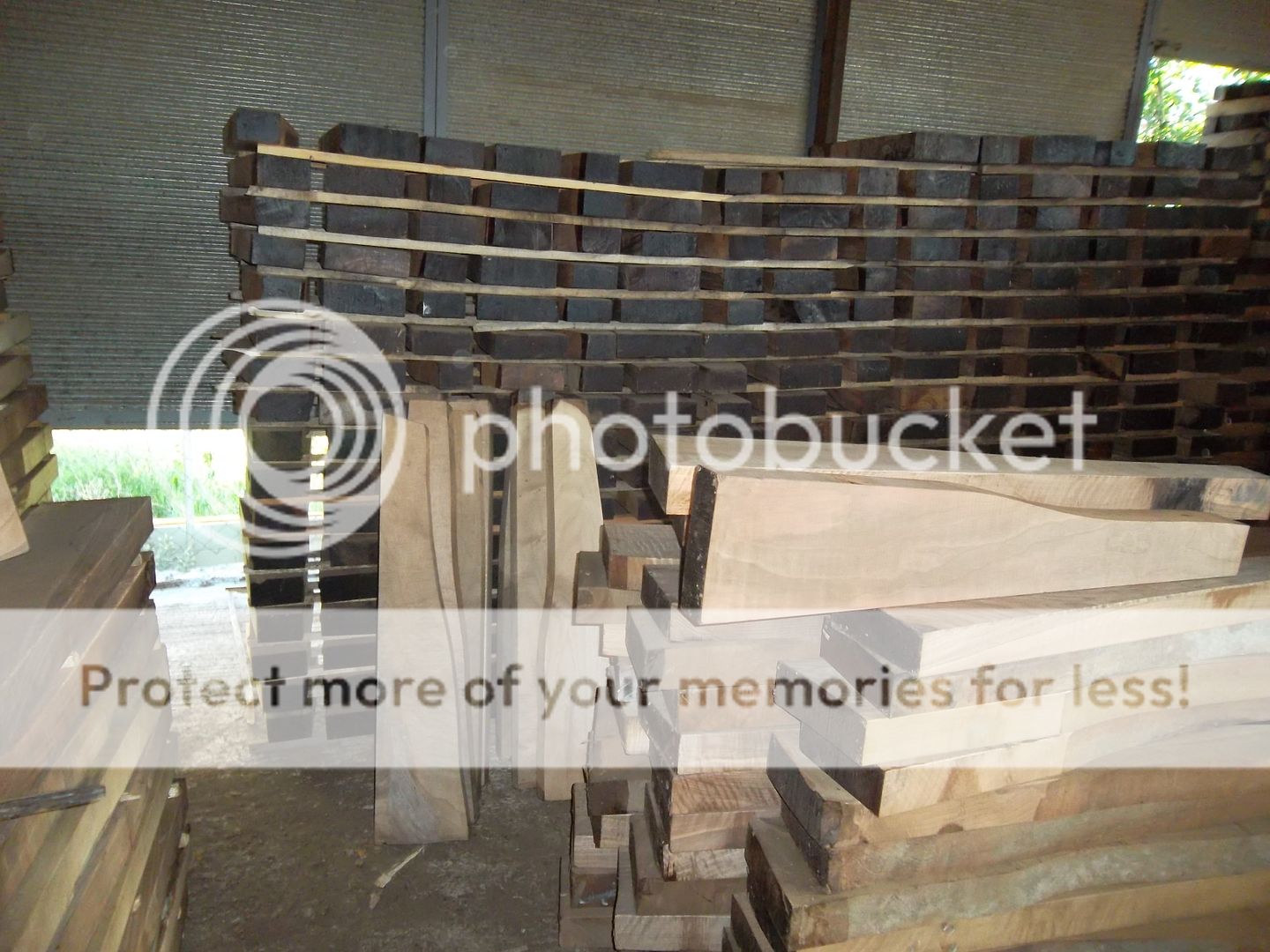

Same factory or closely related. Some photos from their stock walnut storage
