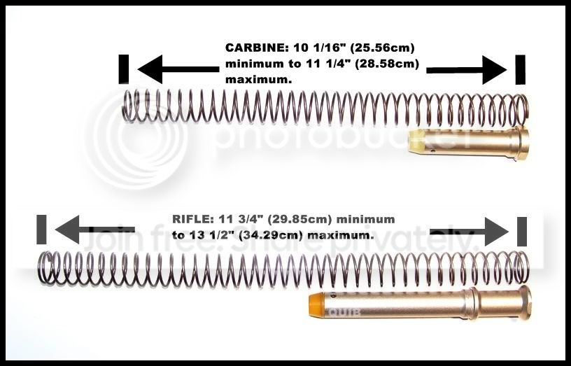

I swapped out the gas rings and installed an enhanced extractor, no solution... then I swapped out the buffer spring, on the assumption that the old one was worn out, and replaced it with a new carbine length spring. That made the problem worse somehow - it failed every shot with Pmags and every few shots with LAR-15 mags. So...maybe a carbine length spring wasn't the right one, but it's a 14.5" upper sitting on a Bushy XM-15-E2S lower, so I think it does need the shorter spring. The issue is the same as before - the spent brass is extracted but rotates up to 180 degrees in the breech and doesn't get ejected, then it strips another round and everything gets jammed up.
So now, by little more than the process of elimination, I'm going on the assumption that it's overgassing and everything is just happening too quickly in the breech, so I'm thinking of replacing what I believe is a standard weight buffer with an extra-heavy one, around 5.5oz. It's the last thing I can think of. I have a hunch that the solution is probably pretty simple...and it's out there somewhere. Thoughts?
