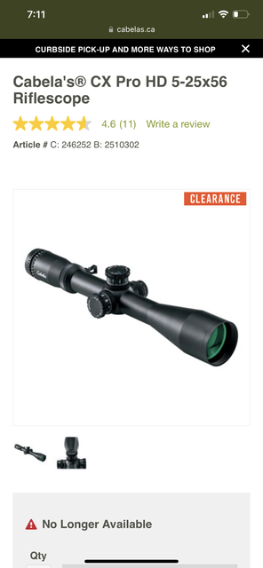

So the objective diameter is 56mm(2.205”). 34mm(1.339”) divided by 2 then minus the two numbers.
I need a minimum height of 11mm(.433”)or Just 56mm -34mm=22mm(.866”) . I’m confused lol
Thanks for the help cgn.
Finally got the scope in. Took some quarters and stacked them up. Need the height of 8. Or 12.88-13mm.
Had gotten into contact with Alberta tactical and was told I need low rings? Alittle unsure of that so I just waited.
Found cz 34mm rings on eBay from Czechs republic just getting a reply back from him to see what the heights are.
