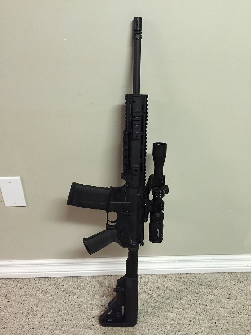

I will do a simple brass check to double check everything is working a-ok. Meanwhile, I finished yesterday assembling everything. Pretty much ready to shoot now. As mentioned earlier, a C-8 iur upper receiver, with a Daniel Defense bolt carrier group. It also has a Magpul Moe + grip, Bravo B-5 stock, DD 1'oclock offset rail. Dlask Arms lower receiver. Vortex Diamondback 2-8X scope on Burris PEPR mount. The buffer tube, buffer, spring etc were nothing special, just the first I came across. Hope to get a new trigger in a month or so. Just the standard trigger now.
http://i1056.photobucket.com/albums/t367/loctl789/IMG_1980_zpsvqgddad6.jpg
http://i1056.photobucket.com/albums/t367/loctl789/IMG_1982_zpsfflvqkgq.jpg

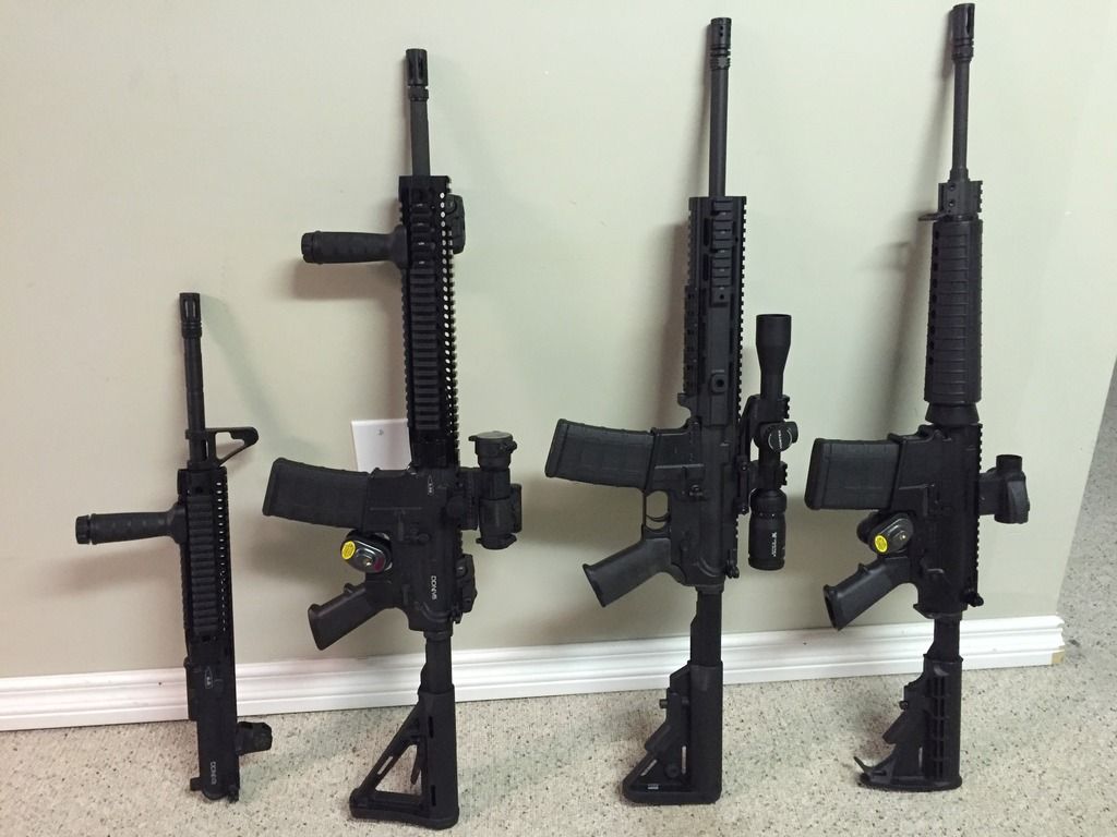

I bought my first one a year ago yesterday. From left, a Daniel Defense M-4V3 upper only, in 6.8SPC. Then a Daniel Defense M-4V5 in 5.56mm. An Aimpoint Pro and Magpul BUIS for sighting. The third is the C-8 IUR. Last but not least an Armalite AR-10A in .308, with a Vortex SPARC.
