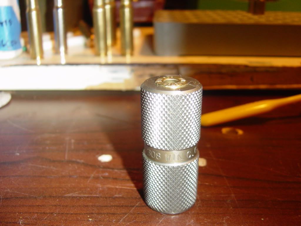

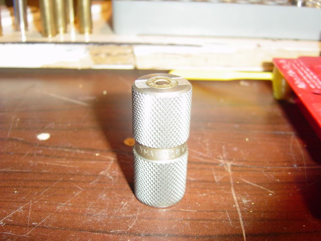

I re-sized a bunch of brass today... I did about 50 in the same re-sizing die without making any adjustments..
when I put them in my headspace gauge, 5 of them were out of spec..
they stuck out 47 thousands of an inch from the top of the gauge..
all the others were 10 thou, which is the actual length of my chamber..
I ran the long ones thru again with the same result.. any ideas why they wont size to the same headspace even though the die setup hasn't changed?
see pics below.. the first pic shows a .047" (out of spec) and the second pic shows a .010" which is within the specs of the gauge.
the cases were all trimmed to 2.005"

sorry for the big pics.. i'm new at pic posting...
What i did was:
I took a fire formed case.. I set up my re-sizing die using the "smoked case" method..
I'm assuming this gives me the exact dimension of my chamber from the base of the cartridge to the shoulder..
This is what i measured with my calipers and the cartridge gauge to be .010" (i also had Hungry measure one of my cases at his clinic and he told me I had a "10 thou chamber")
I figure for maximum accuracy and consistency, I should make all my cases "10 thou"..
does this make sense, or am I "out to lunch"?
for the record, the cases all chamber in my rifle properly.
what I dont understand is why some of those cases didn't size to the same measurement using the same setup..

i'm shooting these in a Norc M305.. I full length re-size all my cases.
the case is definetly being measured off the shoulder.. i put the case in the gauge backwards to make sure that the bottom of the case wasn't binding.. there's no burrs that i can see or feel on any of the cases.
both chambered in my rifle without any problems. i loaded a bunch of the .010 mil cases and they shot a 1 inch group at 100 yds.. i also loaded a few that were .006 mil with same results.. maybe i'll try a couple of the .047 just to see..
I've been loading for about 5 years for this rifle and i've never had any problems of any type... i'm sure that i've loaded cases all over the .006 to .047 range, i just didn't know it.. i just started measuring the cases recently after i bought the gauge..

valmet 762, that sure is odd. Putting the case in upside down does seem to rule out the casehead hanging up on the gage's mouth. And yet both the "+010" and "+047" cases *do* fit in another similar "gage", i.e. the chamber of your rifle....!
I notice that your case gauge is sitting on your table surface. Any possibility that the "+047" cases are overly long, and their case _mouths_ are sitting on the table surface? If you hold the gauge in your hands, will the case go all the way in (and .037" of case mouth stick out the other side)?
Any chance there's a ding or a bulge in the case that your sizing die hasn't fully removed? (sounds like a long shot, to be honest)
Do your "+010" cases slide in easily and stop with a solid "clunk" as they hit the gage's shoulder? Do the "+047" cases also do this, or do they slowly fetch up and bind as they go in?

the cases are trimmed to 2.005" and all go in nicely without binding... I'm sure they're resting on the shoulder, in the gauge..
not all these cases were fired out of my m-305.. I'm going to resize some of the longer ones tonight and let you know what happens.
