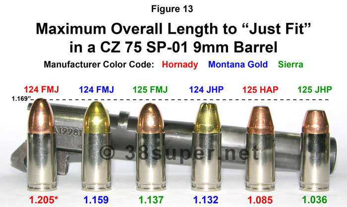

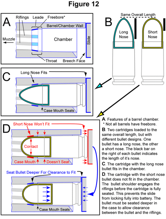

S&B brass is thicker and the primer pockets are tighter. You can (and I have) load them successfully but I don't bother with anything other than the popular domestic brands (Remington, Winchester, Federal etc.). Does your sizing die make contact with the shellplate? How did you determine your OAL? Hopefully you didn't use the listed OAL's provided in data/manuals, always determine your own OAL. I doubt your firearm wouldn't go into battery because of the S&B brass alone. Load a few dummy rounds and plunk/spin them in your barrels.
P.S. It's usually best if you give us all your load details so we don't have to guess. e.g. 147gr CamPro over 3.6gr of Titegroup with an OAL of 1.09 and a .378 crimp.
