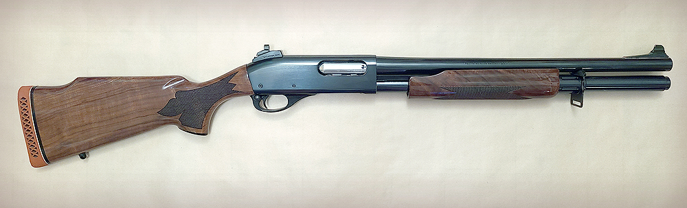

I have this nice blued Remington 870 Police and that I bought brand new a couple of years back (2019) …. I love the gun … but it has had one issue since day one and when I first took it out to the range. At first this was not a big deal …. but lately and practicing quite a bit more with my 870s … this issue is starting to annoy me …. :-(
During dry firing and cycling the gun with dummy rounds the gun functions flawlessly.
However, when shooting “life” ammunition and under recoil … the action bars lock up after each shot … and so that the gun cannot be cycled. I have to release the backward pressure on the forearm/action bars for a split second…. or move the forearm/action bars forward one millimeter …. and then the gun will cycle smoothly.
So, something is locking up the action with backward pressure on the forend … and it only happens after firing a life round and under recoil. And non of my other 870s have that issue.
All my other 870s release the action bars immediately after firing. Firing and cycling is one smooth action. But with this gun …. it is firing … racking forward and then backwards …. :-(
Has anybody encountered this issue before? If yes, what was the fix?
