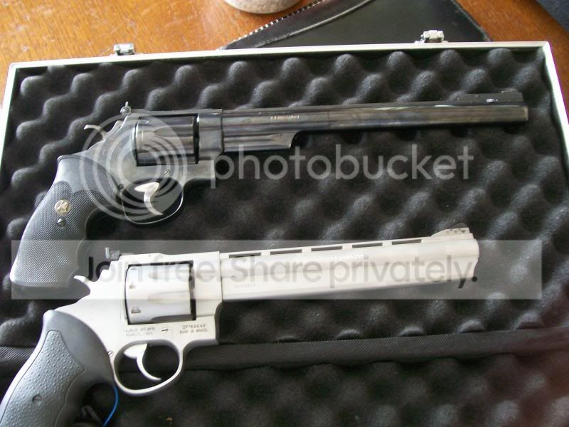

I loaded some at...11.8 12gr. will try them out at the range tonight. The gun I'm using is a smith & wesson Dirty Harry model with a 10 inch barrel.
