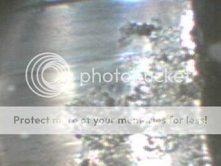

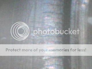

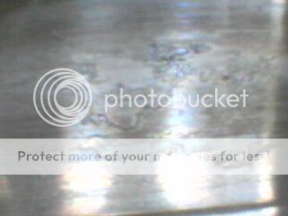

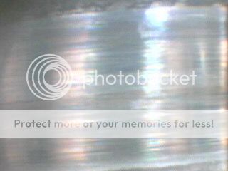

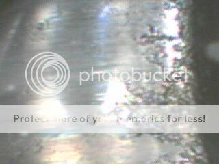

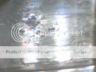

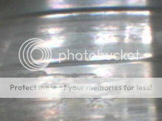

Hey to the experienced, experts and gunsmiths if you could lend an ear and maybe provide some thoughts or comments to what is happening with this barrel. Excuse the average photo quality but this was done with a USB bore-scope and no 90* mirror. This is a friend's TRG in a 308Win the picture are of a before and after a cleaning with slip2000. Lots of copper and carbon before cleaning. The chamber cleaned out good and part of the barrel cleaned out did OK as well. After cleaning you can see some copper still but as you get near the last 1/4 toward the crown it's looking real bad. Don't understand why it would be like this near the end of the barrel?? Any ideas? Thoughts and opinion about the condition and life of the barrel.
The barrel has approximately 1600 rounds down the factory barrel threaded muzzle. Loads are moderate mostly shot with 168 and lately Berger 185s.
Thanks in advance.
Chamber before cleaning
Barrel before cleaning
Chamber After cleaning
Barrel After Cleaning
1/4 towards the muzzle after cleaning
This is where the bullet is traveling at its fastest velocity before leaving the bore. At this point the jacket is likely getting pretty hot and leaving more material behind.
When this material isn't cleaned out properly, then there can be issues. The issue here is that slight surface flaking has started. After 1600 rounds that's normal.
There are all sorts of reactions between the jacket materia/carbon/chemicals/bbl steel. Allowing the barrels to get very hot can cause this as well when a proper cleaning regimen isn't followed.
Mostly though I would say you are looking at normal wear from burning gasses and friction.
That throat shows a bit of nitrating/erosion as well, also normal for that many rounds.
Well first off you need a real borescope if you want to see anything but you kind of know that I think , barrels burn out in the throat area for a few inches just ahead of the chamber and a 308 with 1600 rounds should still be good for another 1600 or more depending on how competitive you want to be.
It's really hard to tell from the pics but built up copper will only come out with either IOSSO paste or JB bore paste by tight patching it over a nylon brush works good, I've had the opportunity to do a few over the last little while , the pic near the muzzle could be pitting if it's a CM barrel and if bad enough might not shoot well
Copper will build up more on factory barrels in general and once it starts if it isn't removed it just builds up more and gets harder to remove , I expect that barrel is still good and likely needs a good scrubing with the paste it's not likely a 308 barrel is shot out at 1600
Another cleaning option is to use Sweet's 7.62. It is an ammoniated cleaner that does an excellent job of removing metal fouling.
1600 rounds through a .308 and it should be nicely broken in - should be good for a lot more shots than that.

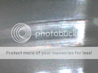

Thanks to OP who posted this up for me and all the feedback. Just as a followup here are some better scope pics. This is a 26" factory barrel on a Sako TRG22 in 308 with about 1600 rds. Majority of the barrel appears to be in good shape with well defined lands other than some stubborn copper which I plan to get out with some JB bore paste. Visible heat cracking right at the throat and some signs of heat cracking at where the lands begin, is this normal? Last 4" of the barrel is what worries me as there appears to be signs of pitting and "squiggly" lines. Not sure what that is but guessing corrosion? Very obvious pitting right at the end of the muzzle. Don't know how to interpret the pics whether this is normal to see for this round count, abnormal, or if the barrel might be done. It shoots great at times doing 0.25 min groups, usually holds steady 0.5 min waterline during matches, but have also experienced recent frustration with wild shotgun patterns, fliers, etc but could be due to other variables/me. Any input greatly appreciated.
Throat and start of lands- heat cracking
Majority of barrel looks like this
Last 4" of barrel towards muzzle
Muzzle end of barrel
...and this thread is a good example why 99% of the bore scopes out there are just toys to play with ... money would be better spent on barrels, components, etc.
Who cares what it looks like as long as it shoots accurate, keep shooting it and worry once accuracy declines.
I am very surprised at the amount of wear given the rd count but, if any barrel is shot with long strings to high temps, damage will occur.
If willing to invest the money:
Chop and recrown that barrel. I would go 2" min. There is alot of damage on the crown and I assume you have not been leaving it soaking in a cup of water :)
What powder are you using?
What bullet?
Maybe be weary of any moisture after your shooting session or how you store your rifle.
The first two pics of the throat/lands are typical but, I would expect to see that level of cracking on a higher rd count barrel BUT hey, every barrel has its own story.
The 4th one down has me curious. The 3rd one down shows a very strong rifling- assume somewhere in the middle of the pipe. The 4th one is almost washed out. Where ever this was taken, go back and review ALL the rifling in this area. If you see a flattening of the lands vs sharp rifling a few inches on either side, measure from the front of the chamber and do tell me what powder/load you are using.

The 4th picture down was a closeup of the lands. Shooting 185 juggs with 44.1-44.3 Varget, before 168SMK with IMR4895.
Aside from the scary pics can confirm the barrel won't shoot anymore so it's time to spin it. Talking with some other folks and smiths they weren't surprised even with this round count. The factory TRG barrel was a shooter and was great last season but longevity wasn't there for Fclass use. Things started going downhill fast near the end of the season last year. Perhaps the metallurgy of the barrel was bad but I'm pretty sure I didn't rest it in a cup of water. =p
