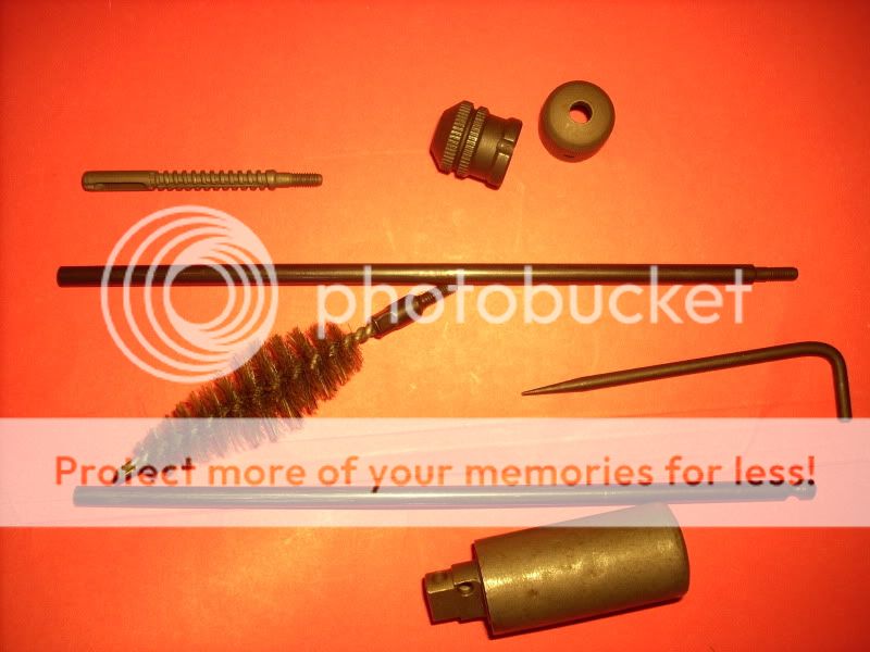

I just found this cleaning kit. No idea when I got it or where it came from.
Judging by caliber and shortness of the rod, it is for M16 or m4 length rifles.
What is 7 shaped pin for?
What are the two little caps for? One is smooth, one has littel cut outs.
Comes in a little canvas bag. Is it Canadian?
It's a Czech VZ 58 cleaning kit.
The L-shaped piece is a pick for cleaning the gas port and the other end may have a slot to adjust the front sight height.
One cap is a blank-firing adapter and the other is a rod guide to protect the crown.
The grease bottle, pick and rod segments go together to form the cleaning rod with handle.
