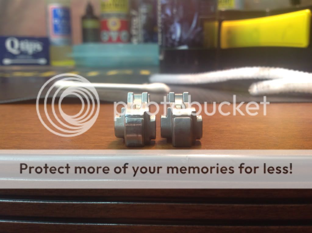

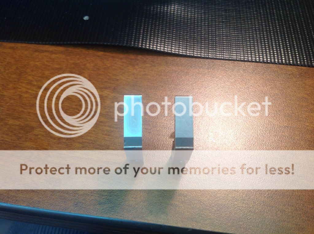

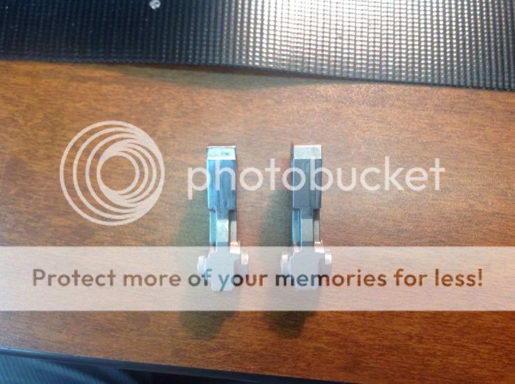

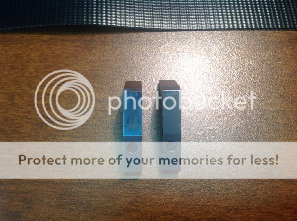

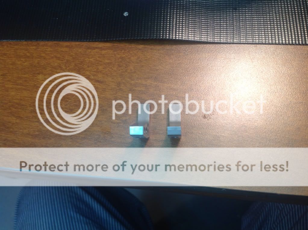

Underneat the hammer. Polish. Polishing method was same for all the tune, vise gripped sandpaper to the anvil part of the vise, passed it a few times in a very level way so not to change angle on things, cleaned with cleaner and inspect to check if it shines enough. For underneat the hammer i rolled the hammer as i sanded it.
When i show these pics it'S just to show areas to polish. Not a lot of effort is needed on the 1000 grit sandpaper, being on an anvil helped a bunch to put some pressure on it tough. I usually stop once it'S mirror like.

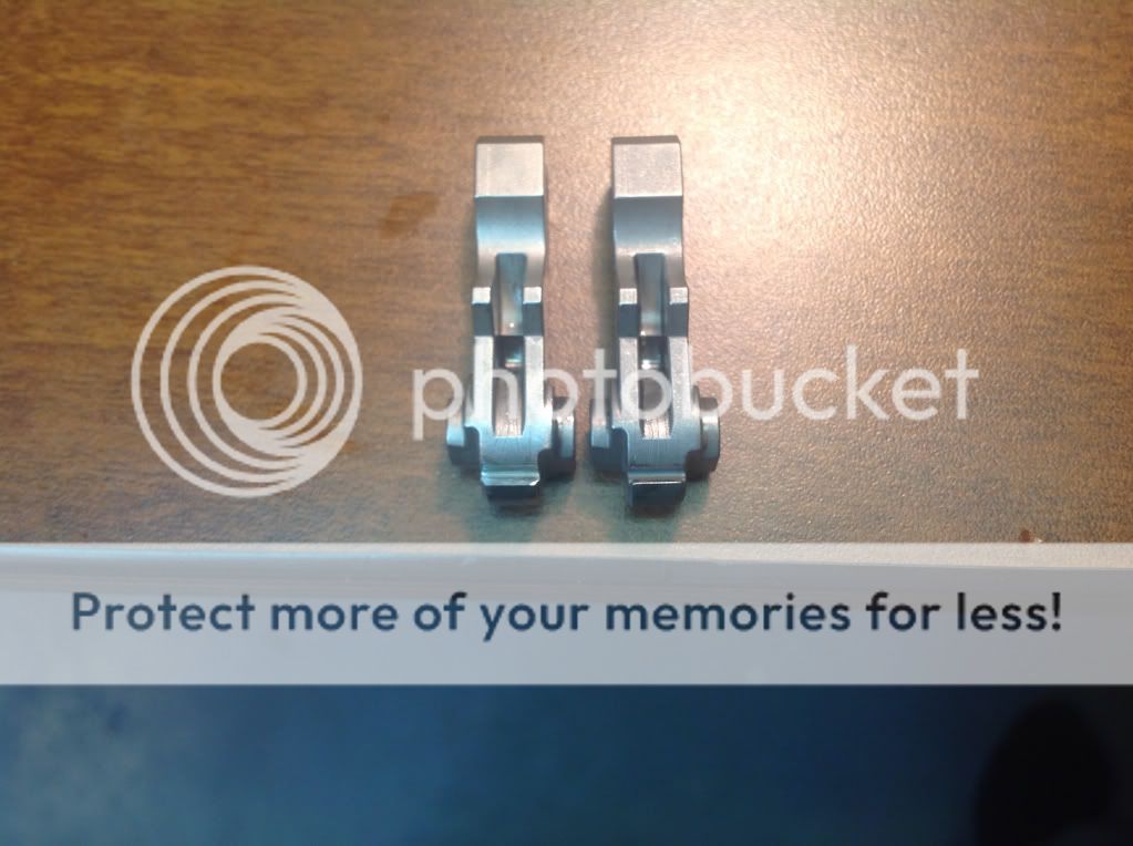

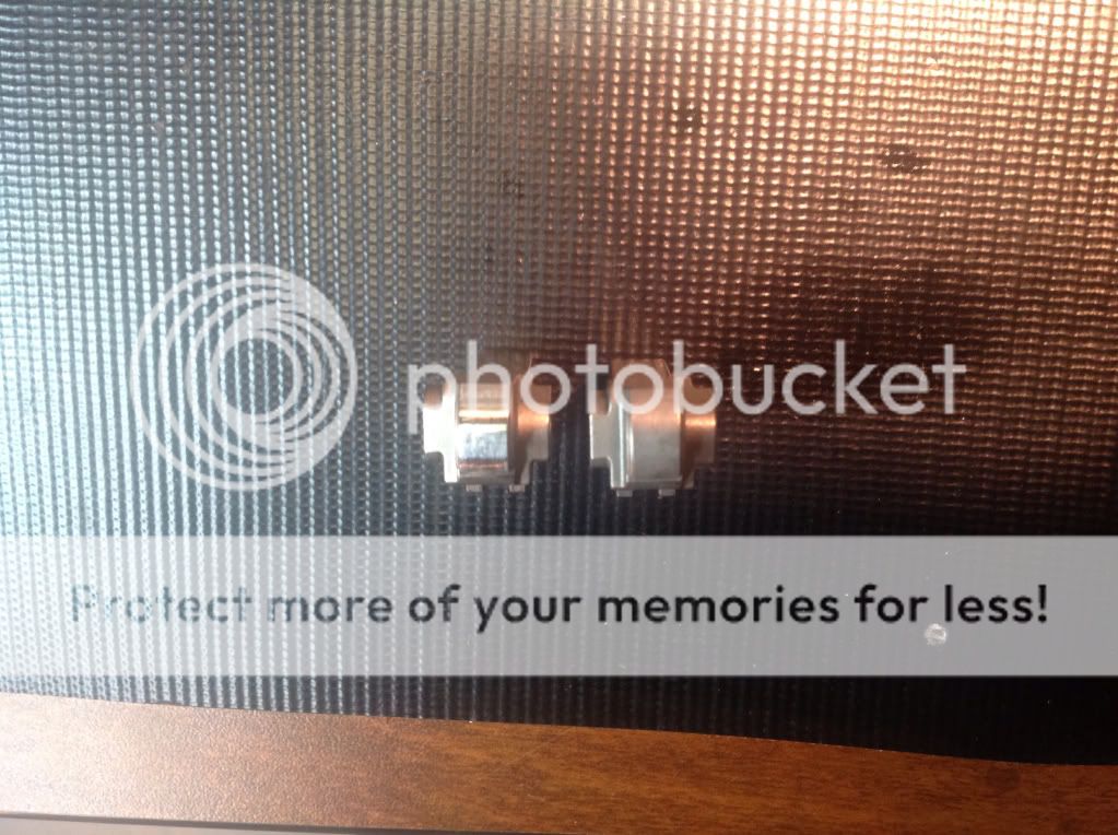

Showing the hammer notch grind from the top.
I put my hammer in the anvil, exposing only a fraction of the notch at a time. I would check with a level to make sure i only had tiny bits exposed at the time. Dremel with cutting wheel was used to take off material. I then remeasured hammer on side of table with caliper until i reached the measure on my modified hammer. I unfortunatly did not take this measure as a reference, but taking hammer out is easy and can measure and take a pic for reference if there is any interest.

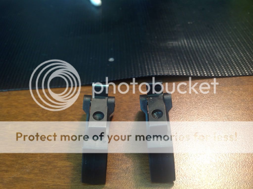

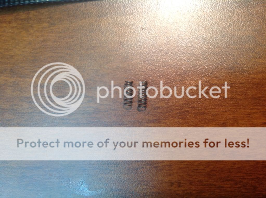

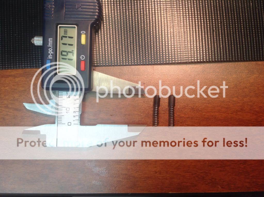

I will call this plunger spring. 1 coil exactly was taked off. The portion of the spring sitting on the plunger has been squeezed. So putting spring back on plunger was real hard, i had to twist as i put it in. To take a coil out, i used mini longnose in the spring to hold it tight, and simply used the dremel cutting wheel so snap the coil off.

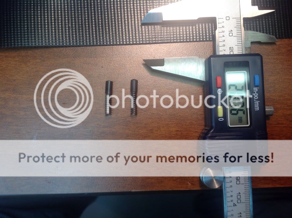

I will call this sear spring, i will research and modify later if i made a mistake. 1 Coil exactly was taken off.
