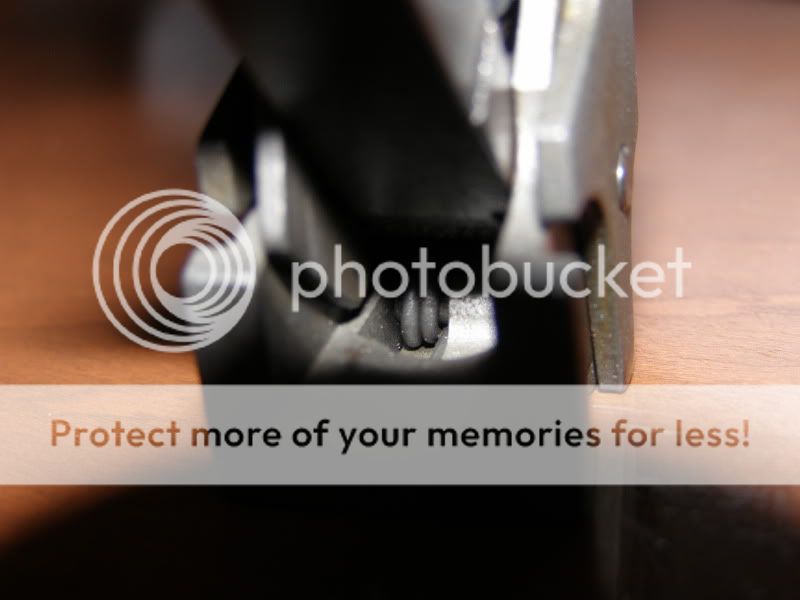

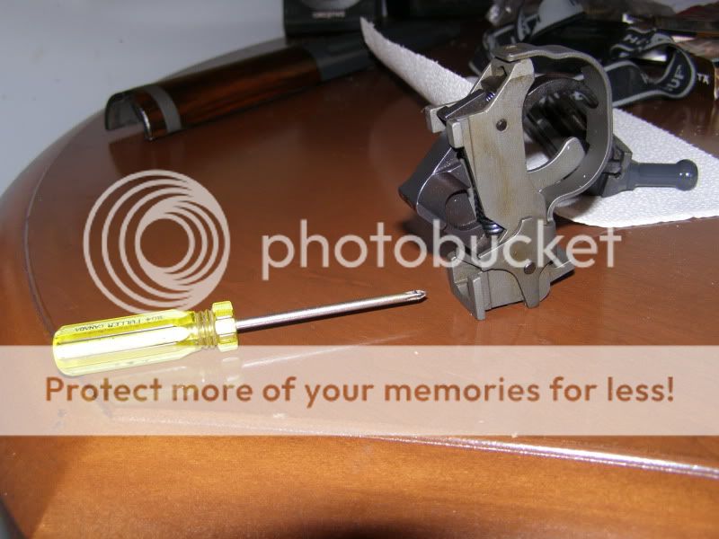

I just took about 10 pics and this was the best one.
You can see the short end of the spring to the right of the coils.
The pic was taken in the same direction as the screwdriver is pointing.
Crappy pic but hopefully it helps.
Thanks very much for the picture... it confirms where I figured the short end had to be. Can you tell me where the long end is situated? Is it lying flat along the inside of the bottom of the trigger frame or is part of it actually exposed in the gap between the trigger and frame? In other words, if you lift up the trigger guard, can you see any part of the spring?

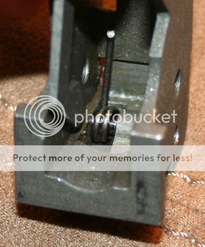

Thanks again for you help... I think I finally got it into place:
Once the the catch was in place, it took me another 10 minutes to get the rest of the trigger group assembled (I'd already done it once prior to discovering the issue with the magazine catch, so had developed some techniques). Function checks passed, and the rest of the rifle is now back together, clean, and ready for the next time at the range :)
