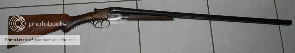

I just picked this old timer up. I think it's really nice. Hinge is solid, everything feels SOLID! I like. Better than the used Winchester 2200 I picked up in terms of durability. I dunno... Being a first time shotgun owner, I don't have much opinion besides that this old timer is really cool!
Now the important stuff:
on the left of the number "22" it says JBW.
On the far right are the letters ELG inside a nice looking egg.
Thanks!
But the dealer doesn't have much info about it except that it's in great shape and the following description:
"12 gauge double barrel hammerless F & M shotgun (what does F & M mean? lol!). Made in Belgium pre WWII. Bores clean. 70% original bluing. Case hardened receiver..."

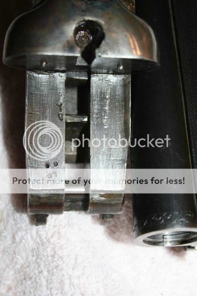

john777 - the following URL should offer insight to your sxs. Compare that to the proofmarks stamped on the bbl flats....the image in the thread isn't vivid enough.
Looks like a nice clean shotgun though.
http://damascus-barrels.com/Belgian_All_Proofmarks.html

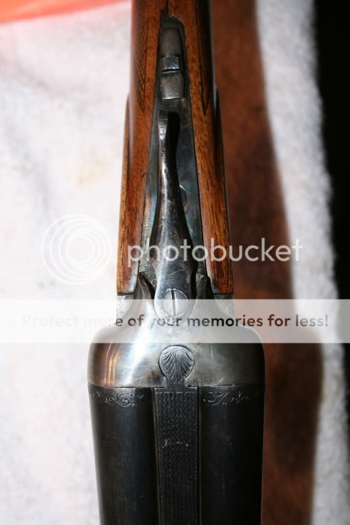

if you turn the 3rd picture upside down it looks just like the first symbol on that proof mark page.

So, it's made in 1933 and was inpsected by lots of people. I identified 3 inspectors. K, O and W. K & O made sense to me b/c these inspectors started in 1930 and 1928. But W shows that the guy started in 1952!
I'm trying to figure out the trade mark. It's 6LD so it's either Dumoulin Lambert or Demarteau Jeanne. However, I don't know forsure, the number 6 in front of LD is a mystery to me.
It's has The Perron Proof and provisional proof of of barrels and black powder proof. So now I'm a little bit worried if this 1933 shotgun can handle my Winchester super target shells.

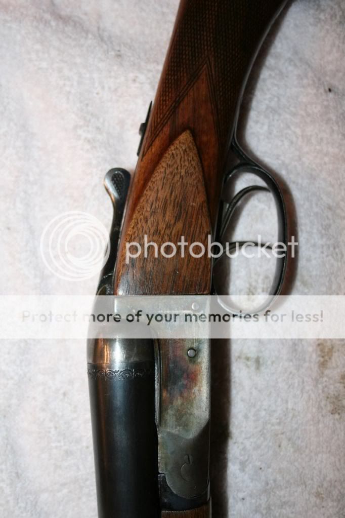

I was able to ID everything except for 184 and a group of symbols beneath it. 2nd pic is pretty clear. You'll see 184 and then below, a crown on its side with what looks like to be the letter D on its side and the number 3. Oh, and the front of barrel has T10 marked on it. Don't know what that means either.
This shotgun looks to be in amazing condition and never occured to me if it can or cannot handle modern shells. If anyone knows its safe, please make a suggestion. I'll be bringing it back to the dealer eventually to make sure.
