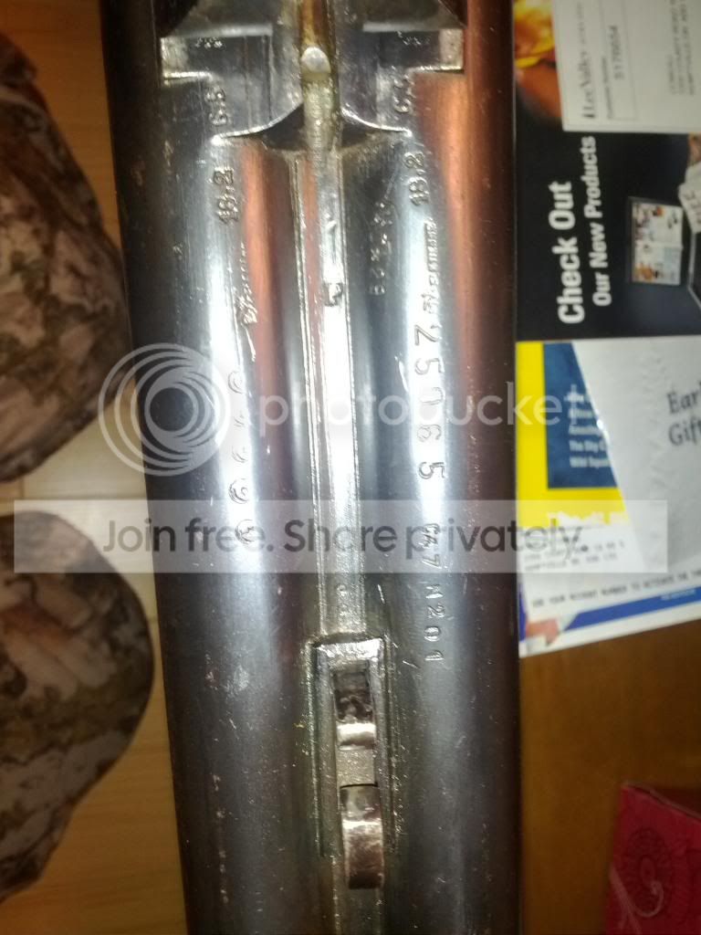

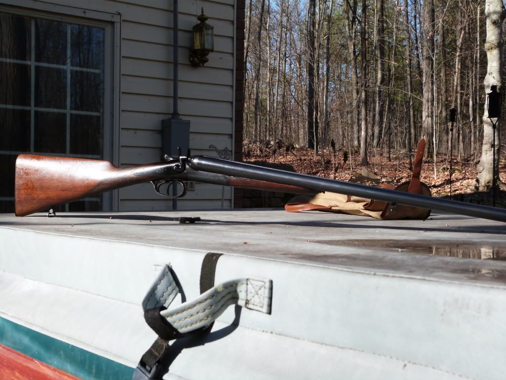

My great uncle was given this shotgun by a friend who was "older than time". He has no idea what it is, or what loads would be safe to shoot out of it if any. I know nothing about these classy guns, but it seems reasonably well made and would make a nice grouse gun. Any information would be great (gauge, shell length, maker, approx age, etc). I apologize for the crappy pictures, all I had was my phone.
Other markings include:
acier de surete
Bondin
Le Havre
Choke Rectifie (modified choke I believe)
St Etienne
I can't see any proofs on it but with the metric designation of 12 guage (18.8 mm) it is european and not british. My guess would be belgian. Somewhere on either the water table or the breach end of the barrels which mates with it, you will probably find an oval with *ELG inside. If there is a crown over the oval, the gun was made after 1893. You may also find a stamp like a miniature Eiffel Tower (peron) and a stamp like a double english pound sign. Both are belgian view marks.

Belgian manufacture would have Liege proof marks on it. Any picture of the whole gun? and / or better pics of the stampings (less light) ?.
I'll try to work from the actual pics, but they're not very clear...

The french made some very good shotguns at that time, and there is some chance this one could be one of the better ones but it would take better pictures to say anything for certain.

The "maker's name" (at least, the packager or distributor's name) is either Bondin or even Boudin, as both are current names. Parts of this gun may have been made at Manufrance, but not the whole gun, as the "Bondin" name is not one of their trade names. Like previously stipulated, there was a "guild" there who used parts made by others to assemble shotguns.
I can say without great doubts this gun was made between 1900 and 1923 and was proofed with black powder at 14 223 PSI. There may also be somewhere a "Crown" over PT for smokeless powder - now visible on your new pictures, of course if it was intended to use with it (mandatory from 1900).
Also from you pictures, it should be in 12 Gauge 2 1/2" (18.2 / 6.5). If a folded 3.5' shell does not fully chamber, protruding about 1/2" out of the chamber then it's still a 2 1/2" chamber (If you try that, be smart and do not attempt to close the action and fire the ammo...). "Choke Rectifié" means "calibrated" choke, "Portée Garantie" means it"s a "long distance" gun, the chokes being 18.2mm (0.716").
I can't read the words in a arc, but usually it relates to the steel.
The "Acier de Surete" stamp is the equivalent to "Fluid Steel" which means it's not a damascene barrel.

It is a classic French hammer gun and that means the quality and workmanship are most probably several steps above most Belgian products of the era. I'd be quite happy to own it.
