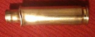

Need some help here, new to reloading and not sure what to do. Started up a resizing and de-priming session last night using a Lee collet neck sizing die on an RCBS Rock Chucker press, and after a couple of successful resize/decaps, the collet appears to have started getting stuck(?) and crushed a couple cases, quickly ending my session. I used the die to do a 100 cases a couple of days prior with no problems, and all of a sudden this. See the attached picture for what it's doing. The collet marks are at the top half of the neck. The case de-primed normally, felt right in the resistance for de-priming and sizing, but the result when I pulled it out was it being crushed. WTF?

You have to take the top out of the die, push the collet out, use a taper punch and carefully spread out the fingers of the collet. What is happening is the fingers are too tight from being pushed in with out a case, they grab the neck early or partially and as you continue to push up the unsupported neck is forced down into itself. Dont spread the fingers too far or you wont be able to reinsert into the die. If you have a good unsized case handy as you open the collet try it for fit, the case should slide in right up to the shoulder easily. Put a small amount of oil on the outside of the collet to help it slide but not the inside. Hope this helps.
Maybe the neck on the brass was already tight, and the collet pushed the neck down. At what point did it collapse? Near the end of the stroke?

I went home last night and using a very unscientific method of trying to find the definitive source(s), I went to work. I took the die apart, de-greased it with Simple Green and dried it in the oven at low temp. I polished the outside top of the collet and separated the fingers as the case would not slip into the collet easily. After separating the fingers to the point that the case would slide in, I greased the top of the collet with Teflon grease, and reassembled.
I paid close attention not to seat the die too far down and not push the collet without a case in it - touched the shell holder, stopped. Added one turn. I also realized that the nut on the outside of the die is an indexer, and not a lock washer. The further up the die it goes, the lighter the neck tension. The further down, vice-versa. Using a bullet I had lying around I gradually lowered the nut and tested it on a case and found the sweet spot. The cases sized with aplomb. Getting cocky at this point I played with the seating depth of the die to find the right depth to allow the press to just cam-over and size the neck as mentioned by larry20082. Made for perfectly consistent neck tension. I went on to size 140 cases in about a half hour with a s**t eating grin on my face as the cam-over makes it a no-brainer. I'm a happy man. Thanks to all who replied, a little bit from each post allowed me to figure out what was going on and remedy it.
