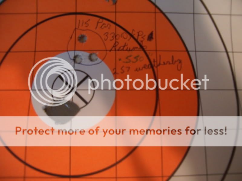

I have a custom rifle on a M700 action and I use 71.0gr of Retumbo with WLRM primers, for 3500fps.. That is Max so start at 64-65 gr. and work up.A pic of the loads accuracy. The pics are not real clear but both loads are 1/2'' groups.
here is a pic of a second load that works well 115gr partition with 69.5gr of retumbo
