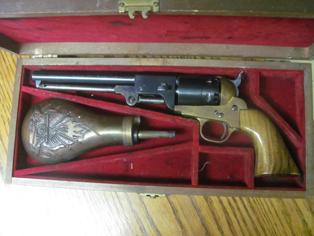

I got this revolver from a neighbor. It's clean with a great bore and he says it was a good shooter 10 or 15 years ago. It's a Navy Arms but I read that they were built by Uberti.

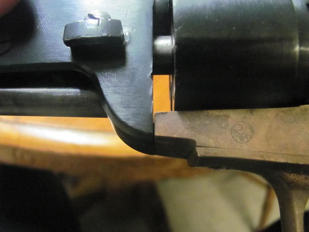

It's got issues though. When you put it on full ####, the cylinder it pressed forward but if you give it a little tug you can pull it right back and the gap measures .030". This can't be right. Would it even be safe to fire this way? It seems like an excessive gap. I also notice that when at half ####, the click is absent when you rotate the cylinder. If you hold pressure back on the cylinder while you spin it, you'll here the click.

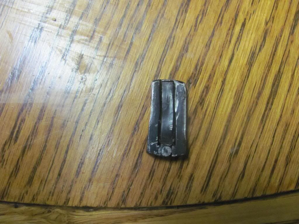

Also, the wedge spring doesn't hold it snug anymore and the wedge itself is deformed. Maybe someone shot excessively hot loads in it or something. But the barrel is held snugly in place. I can't even wiggle it.

This gap looks worse in the picture. Along the bottom and on the other side it appears tight.

It definitely needs to have a new wedge fitted. Keep in mind that the wedge, base pin, barrel and frame are interrelated.
I would fit a new wedge first, and if that didn't solve the problem, I would move on to a new base pin.
Looks like someone was prying on the lower portion of the barrel/frame, some of these guns are hard to take apart after shooting due to residue build-up on the arbour.

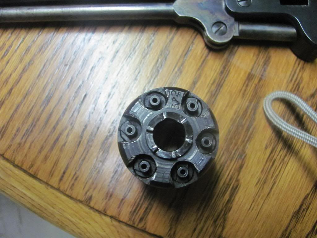

Sounds like a weak hand spring if there is no click at half ####, weak or broken hand springs are quite common with these guns (the hand is the thing that advances the cylinder by engaging the back of the cylinder) try cocking the gun with the muzzle pointed up..if the spring is broken it probably won't advance the cylinder when cocked because the hand won't engage cylinder.
If the wedge holds the barrel on tightly it is safe to shoot but keep an eye on it as you shoot, it may loosen up.
The gap is not ideal but is usable as is,to reduce the gap you would have to get a new wedge and modify the bottom part of the barrel where it joins the frame.

I'm pretty sure after reading your comments and studying an exploded diagram that the hand spring is the most likely culprit. I'll also look into the wedge and possibly replace it.
I got it apart and it appears as though the hand spring was broken and then a groove was made and the spring soldered back into the groove in the hand. Unless that is how they are built. I found the spring just bent instead of springing. It looks to be all steel so I tried to temper the spring and the solder melted and it fell off the hand.
