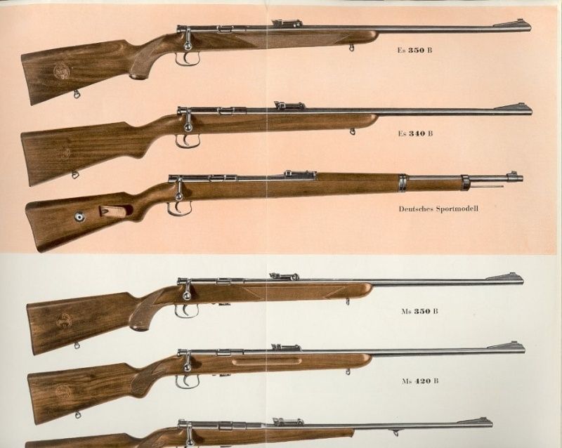

Here's a picture of some contemporaneous models. Rimfire Central has a number of threads with interesting bits of information.
Thank you both 9.3mauser and grauhanen! I confirm the Mauser cartouche is present on the stock, above the rear sling swivel. Therefore I don't believe the stock has been refinished. I agree with the suggestion that the bolt may have been altered - the entire bolt handle assembly is not blued, and the shape and angle of the bolt handle on my rifle are very different from the photos of other es340b's. Also, the "flag" safety on the back doesn't rotate - it appears to be pinned in place (or just siezed). All indicators that the bolt is not original! The investigation continues....
