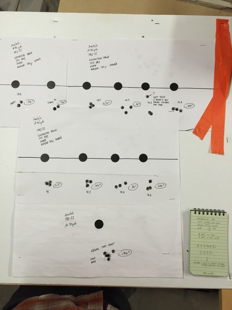

Good day CGN wealth of knowledge.
I was out at the range today to try out a few loads after doing the "barrel break-in" for my Sako TRG-22.
Here are the results:
The loads:
Winchester brass (trimmed to 2")
CCI BR2 primers
H4895 powder
Berger 185gr Hybrid bullets
OAL: mag length (2.901" OAL)
I had planned on doing a ladder test like I often do but then came across the OCW (optimal charge weight) loading method and decided to try it (mostly because it was windy and because it can be a pain to keep track of bullets holes at 300m through a 24x scope). I shot the 10 charge weights into 3 shot groups in a round-robin way, making sure the barrel never got too hot to touch.
What charge weights do you suggest I work on? OCW says to play with seating depth but I'm more interested in being able to use the magazine.
In case you can't see the photo too well the charges from left to right are as follows:
39.8 40 40.2 40.4 40.6 40.8
41 41.2 41.4 41.6
Federal soft point cheapo hunting ammo (can't remember what bullet weight)
* I have no idea what happened on the 40.6 group, I really don't think I pulled the shot that high but my recoil control might have sucked. Then the third shot landed right on top of the first. The third shot makes me wonder if this is the "scatter group" or not.
