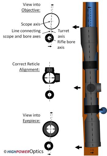

4. I use a 1/4" grid target or make one. Figure out the distance from your bore center to scope center. At 10 feet make sure the cross hairs on the 1/4" grid and the laser point are the exact same distance vertically apart (up & down) as your bore to scope centers. At any distance, until you sight in with ammo, the cross hairs and laser point should be exactly vertical (hairs above pointer).
You are looking for the center one where the perfect vertical height from scope cross hairs to bore is the same on the gun as at 10 feet.
