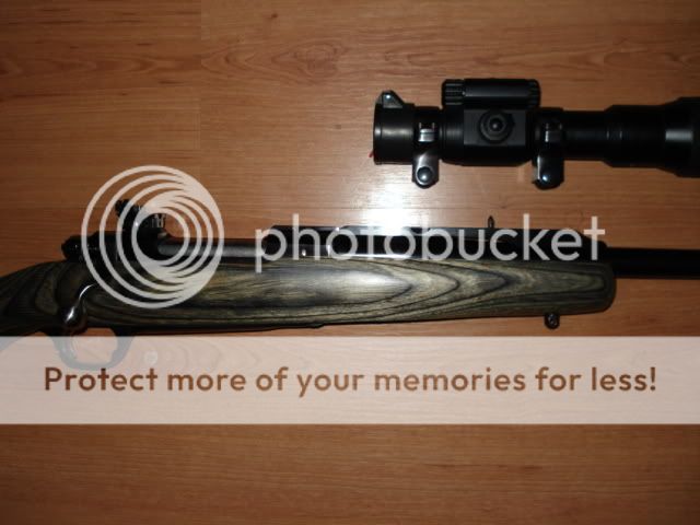

My Ruger Frontier in .308

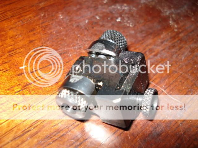

Prototype #1. I threaded A sharpened bolt into the quarter rib and with the peep sight sold by New England Custom Gun . I was able to shoot A pop can at 100 yds. So it looks like I will build on that.
Take Care Steve
ON A side note I had to do A lot of modification to the sight to get it to set straight .
I have a frontier in .300WSM- that one definitely is discontinued. I use a 3x9Burris on the rear using Warne QD ring's and can change quickly to a leupold scout on the rib. I'll be looking into the peep option although i'd prefer to put on an aimpoint instead- but then I have to put on the middle rail and then i can't swap the rear scope quiclky as the scope bell will then interfere with the rail.
