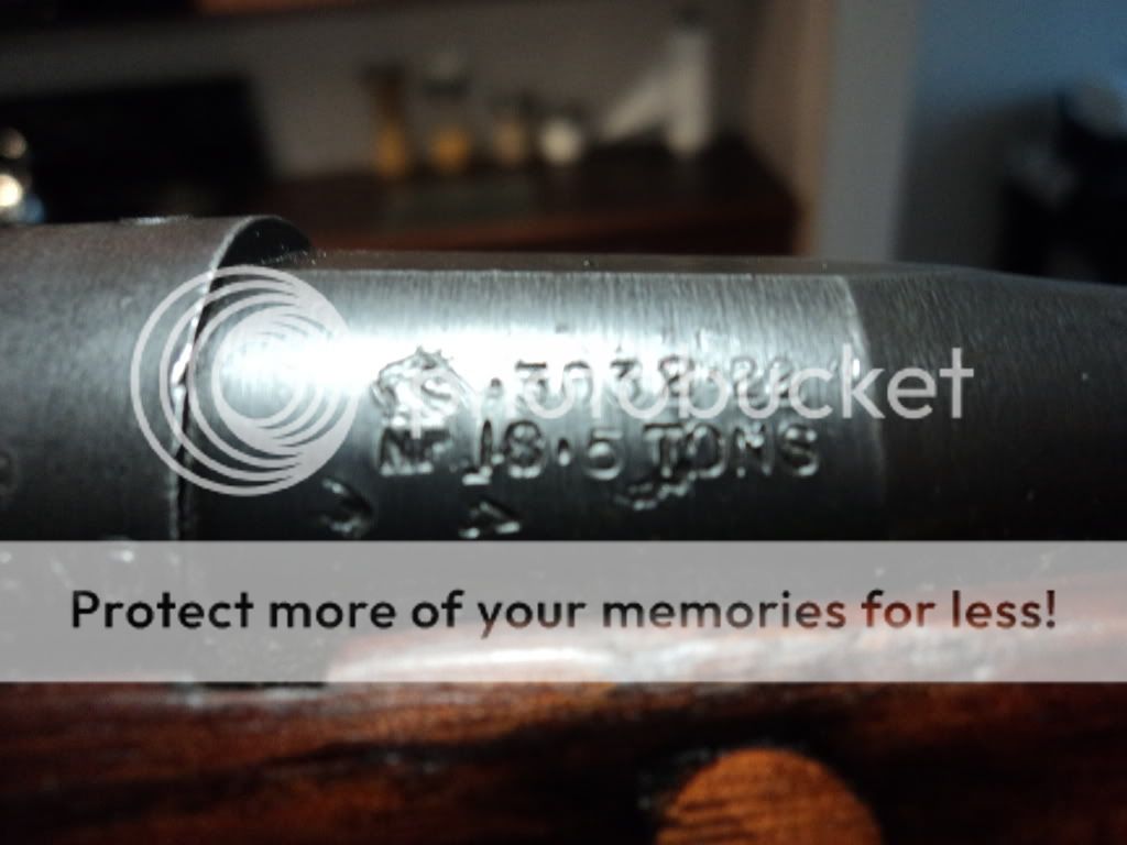

Help please. What do i have?

The "M47C" stamping on the left side of the rifle's butt socket indicates that it was made by Birmingham Small Arms (BSA)-Shirley. It is the same stamping code marked on my rifle, No.4Mk1.
If you're interested in furhter info on stampings, proof marks, marker marks, etc. and the various .303 British rifle out there and who made them, try having a look at Ian Skinnerton's book, The Lee Enfield Story. You can request a copy of it from you local library. It's an extreamly informative book on all Lee Enfield rifles. That's where I started from for information.

On the down side, value wise, the rifle has been drilled and tapped which will hurt it some. However, it maybe a bonus point should you try and have it scoped for target shooting or as a new hunting rifle. Either way the Lee Enfield will serve you for a life time and then some.
