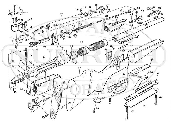

I have a savage model 10fp le1, the piece at the rear of the bolt that does your primary extraction doesn't stay where it needs to be anymore. The little detent balls don't stay clicked into the groove on the bolt body. When the bolt is out of the rifle I can spin the piece by hand with little effort. Also it causes the odd hard extraction. I was thinking it was my hand loads causing the odd hard extract but there are no pressure signs and it's sporadic that it happens. What can I do to fix this problem? Do I need a new bolt body? Do I need to replace the primary extraction piece? Or can I replace the springs under the detent ball? Any help would be great. Thanks
