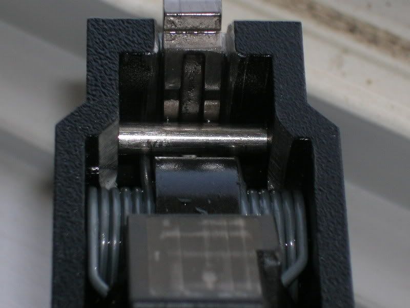

My spring position was already the one closer to the bolt catch. I filed the groove the catch fits into and manually slid the catch up and down to work it in. Also, the hammer hits the indents where the pin for the bolt catch goes. On the factory stock there is a 45 degree angle on the inside and outside of the stock. The conversion has a sharp 90 in the inside. I had to file the inside to a 45 degree angle for the hammer to stop hitting. See pic:
