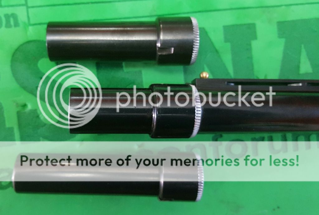

I will get a picture of the chokes for you - seeing as the screw on and the cylinder choke is short in length, it goes from bore to immediate choke lip - not sure how well that reacts with steel, to be honest; hence the questions.
The original chokes are very thin walled outside compared to the steel chokes they show available. Almost like comparing an impact socket to a regular socket. The tighter the choke, the thinner the metal. I really don't know if what I have is sufficient or not, it would be great if it is, but I also don't want to peel apart my Cylinder choke as it is my preferred choke for trap shooting. Here are some more pics to maybe assist.
All three original chokes. Marked as follows: Full = m/m 0.75 Modified = m/m 0.50 Cylinder = m/m 0.25
Inner diameter of the Cylinder choke
Outer diameter of the Cylinder choke
Inside of the Modified choke, going from barrel bore straight to choke lip:

I see. Yes that is a legitimate question. I misunderstood what you were asking.
