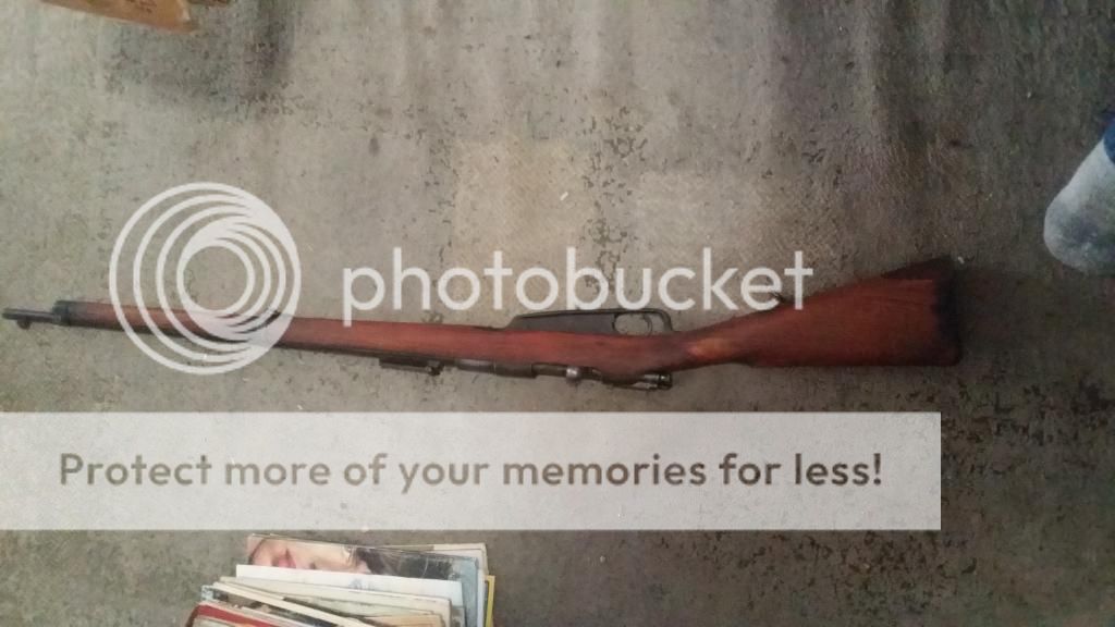

Morning everyone. So I picked this up at a gunshow a few days ago. It was cheap and I didn't have one. So I got it home and was stripping it down last night trying to find any markings on it. There were none other than serial numbers that I could find.

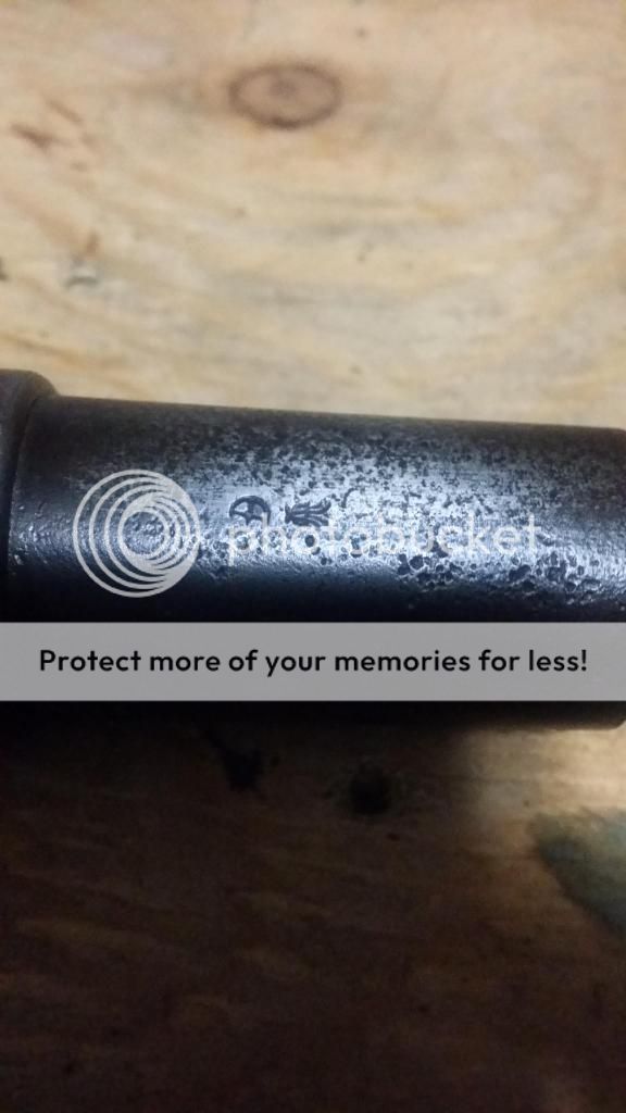

Except for these two little ones on the right hand side of the receiver forward of the breech.
If anyone has any insight onto what this rifle may bee it would be much appreciated.

I can get one tommorow. Someone put a really heavy coat of varnish on the stock so I've been stripping it off and I'm going to bring back a nice oil finish on it. The gun is all in prices right now
and there is no other markings on it? my gew is covered with markings. if its a converted to 8mm the K98 stripper clips I think are the same.
The markings are generally prominent on these rifles unless your example was scrubbed and became a commercial sporter.
Pictures of the parts together would really help as we cannot determine the variant otherwise.

wow cant say much about that. how far back is the barrel jacket cut? . must send more pics. I am interested now.
Only marks are serial numbers and those two little ones. There doesn't look like there ever was a barrel jacket. I'll get some more pics in a while here.

I think in is a Hanyang also. The Turks deleted the barrel Jacket on a number of their rifle during refurbs but the rearsight would have Turkish markings if that rifle was a Turk.
The receiver would also carry the Ankara refurbishment stamp with date as well as have a modified barrel jacket stub for mounting a 1903 style hand guard.

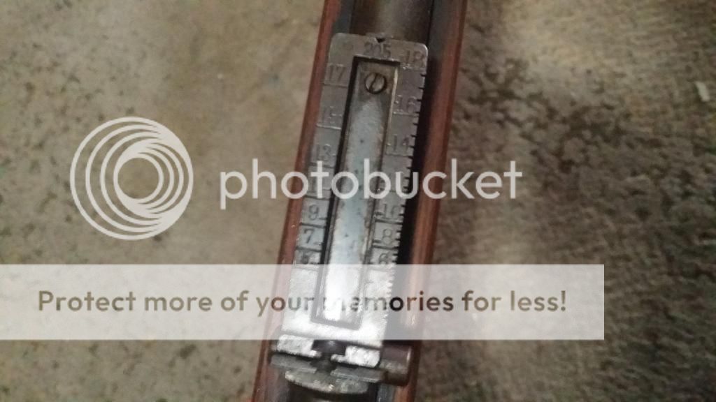

Hmm so based that there is no turk markings. The sight is in western style numerals. Where do we stand ? I've seen a few turk rifles and most of them had alot of markings on them. Never seen a hanyang though. What would the value of a hanyang be ?
