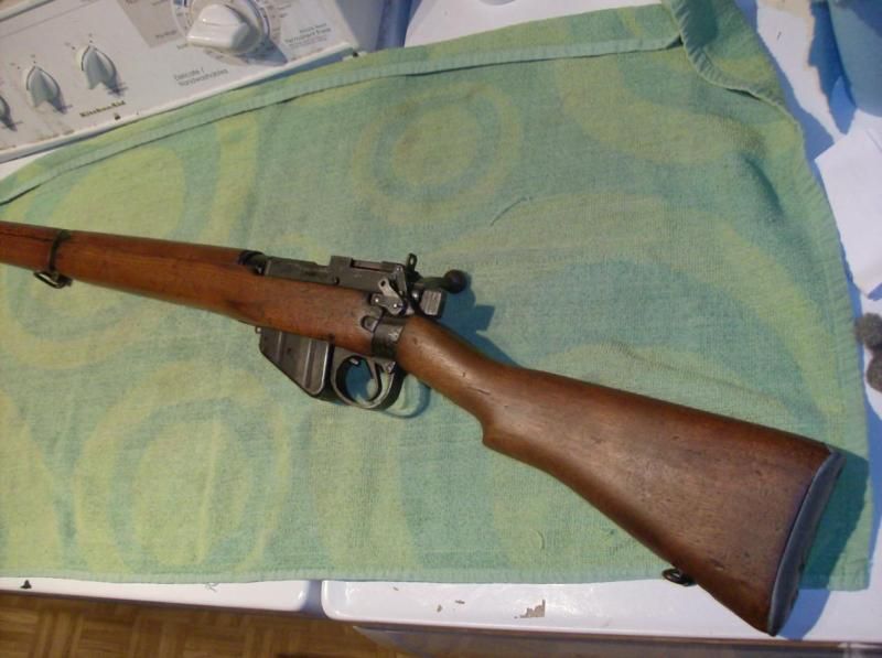

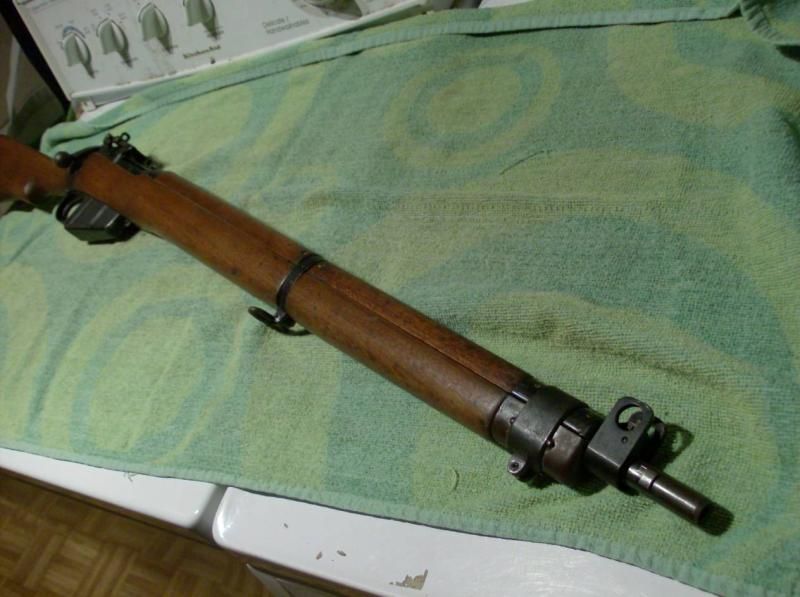

Here's one I actually just finished this week, and the four wood parts had different colour to start with. Brit, WW2-dated, very nice bore - can't wait to try her out at the range!
Lou
